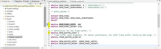

I am working on MIMXRT1062 board . I took the reference of example code of "EVK-MIMXRT1060-guix_washing_machine". In this example it is using two frame buffer of 480*270 pixel for LCD.
The board I am using has display of 320*480 resolution, and I have to use single frame buffer only.
Please guide me what are the necessary changes I need to made for this.

Hello @vipuljain91,
You could try modifying those values in display_support.h file:
[guix_washing_machine -> board -> display_support.h]
Please modify the DEMO_PANEL_WIDTH, DEMO_PANEL_HEIGHT, and DEMO_BUFFER_COUNT (lines 25 to 29) to the values your display has. Example:
#define DEMO_PANEL_WIDTH 320
#define DEMO_PANEL_HEIGHT 480
#define DEMO_BUFFER_COUNT 1
Hope this helps.
