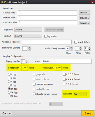

Hello, I'm learning how to use Azure GUIX on an example from SDK.
There is only one example that uses display 720x1280 its OK for me, but I'm looking at how to rotate it. So far I created my own project, changed resolution, and selected rotation clockwise

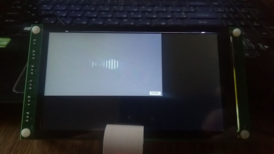

As result, I got a rotated screen but it occupied only half of screen.

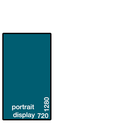

Hello, it's me again. I continue fighting with the screen rotation problem.
This picture is how I visualized in my head what doing GUIX when trying to
display->gx_display_driver_canvas_copy(canvas, &canvas_frame);
So I dived into GUIX docs again and found offset function: adding that call to buffer_toggle helped me
_gx_canvas_offset_set(canvas, 0, (1280-720));

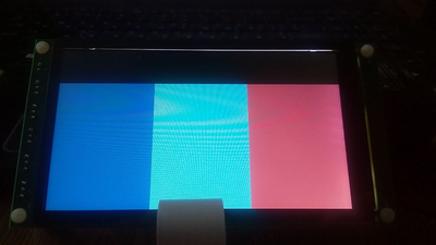

Well, what happens in my point of view:
I see that s_frameBuffer is low-level where I can directly write information via memset and get France flag.
memset(s_frameBuffer, 0x0033, DEMO_FB_SIZE/3);
memset(s_frameBuffer+DEMO_FB_SIZE/3, 0x0055, DEMO_FB_SIZE/3);
memset(s_frameBuffer+2*DEMO_FB_SIZE/3, 0x00AA, DEMO_FB_SIZE/3);
From other examples (which use only driver, without guix or other frameworks) I also got the impression like its the last stop where it all works and I don't need to go to any lower levels.

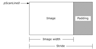

Another important thing is the next parameter:
fbInfo.strideBytes
 On the Microsoft site I found a nice picture which describes how stride works
So I have a width of display which is 720p (or 720x2 bytes) and stride which is 1280x2 bytes. So in my point of view, it means next:
s_frameBuffer[0] ... s_frameBuffer[720x2] - is first row
s_frameBuffer[720x2+1] ... s_frameBuffer[1280x2] - outbounds
s_frameBuffer[1280x2+1] ... s_frameBuffer[1280x2+720x2] - the second row
It is like basic things, but I still learning.

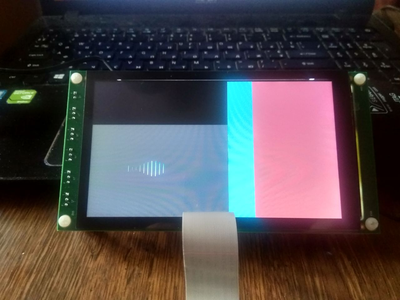

Hi, im working on MIMXRT1170-EVK evaluation board. And with vertical aspect display, so basically example working perfectly without any exceptions, but I need to rotate it in horizontal aspect.
Still not found solution, this is what I got so far.
- clockwise and counter-clockwise rotation work different.
Clock-wise looks like this. Color part is left from initialization, its simple memset of random colors
static UINT imxrt_display_layer_initialize(INT layer, GX_CANVAS *canvas)
memset(s_frameBuffer+DEMO_FB_SIZE/3, 0xFF55, DEMO_FB_SIZE/3);
And grey+black part is from GUIX things, updated by imxrt_buffer_toggle function. So GUIX don't redraw right part of the screen, and colors left there.
And counter-clock-wise looks like this, it's different. I also have the color part from the initialization. But black part is bottom of my window

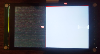

So I used a little trick to make it work:
1. Stride parameter = 1280x2
2. Screen resolution in GUIX Studio changed to 1280x1280
3. s_frameBuffer size changed to 1280x1280x2
4. Moved my window to bottom part
Now CCW rotation shows my window on my screen. But I don't think it should work this way, on this moment I think it's some GUIX bug with rotation. Or I missed something
