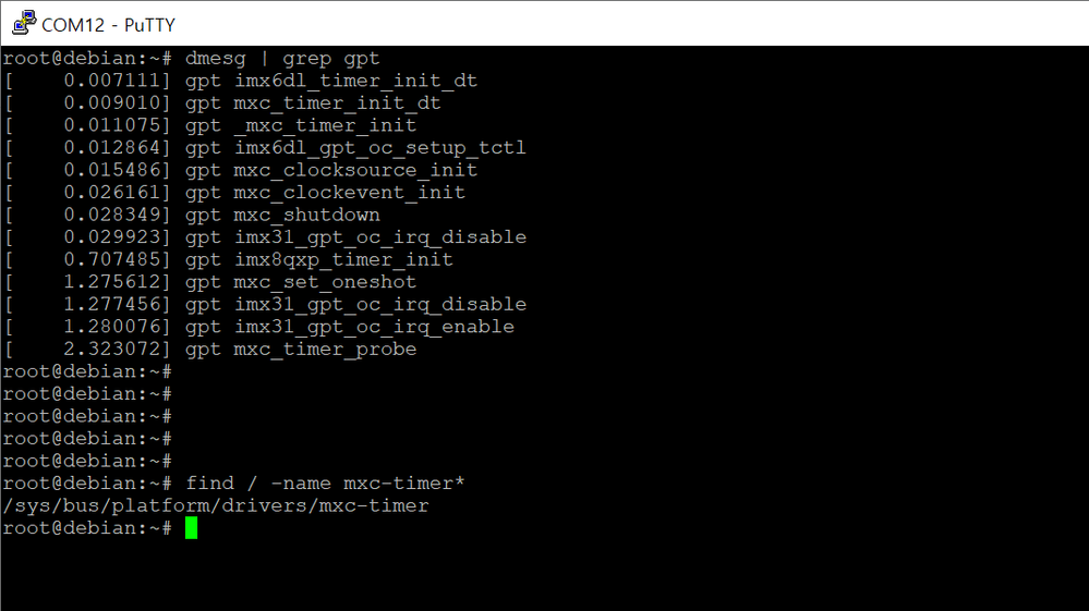

As mentioned above, I modified the device tree and timer_imx_gpt.c source code to get the encoder signal of the motor using the SAI3_RXFS pin.
I checked the probe in the terminal and there was a platform named mxc-timer.
However, the input capture function is still not available.
I now need a specific way of what to do.
