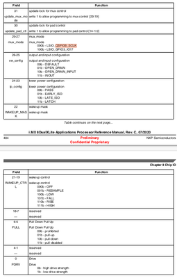

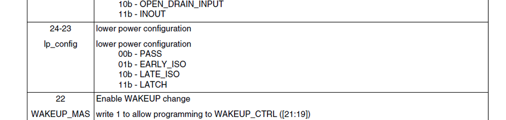

gidame
You can try to set LATCH to keep the state when goes into low power.
9.2.5.1.139 QSPI0B_SCLK (QSPI0B_SCLK)

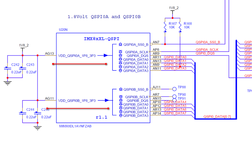

Tanushree
We have connected the GPIO(QSPI0B_SCLK) for regulator switch to the modem. By default, the GPIO is in a low state, which keeps the modem powered on. To save power, we set the GPIO to a high state, causing the modem to disconnect during sleep. However, when the device enters sleep mode, the GPIO automatically changed to a low state.
We also attempted to set the GPIO configuration to "latch." But we are not able to toggle the GPIO it is in low state only.

Tanushree
Hello All,
Thank you for the inputs.
Even after adding the configurations below in the DTS file, the GPIO state still does not retain.
pinctrl-names = "default","sleep";
pinctrl-0 = <&pinctrl_hog>;
pinctrl-1 = <&pinctrl_hog_sleep>;
pinctrl_hog: hoggrp {
fsl,pins = <
IMX8DXL_QSPI0B_SCLK_LSIO_GPIO3_IO17 0x2600004c
pinctrl_hog_sleep: hogsleepgrp {
fsl,pins = <
IMX8DXL_QSPI0B_SCLK_LSIO_GPIO3_IO17 0x2780004c
During boot-up, the GPIO is in a low state, and in userspace, it is setting to high. However, when the device enters sleep mode, the GPIO does not retain its state and defaults back to low.

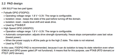

Tanushree
Hello @xacov
In our hardware design, we have not connected any pull-up or pull-down resistors to the GPIOs. However, based on the general i.MX documentation, it mentions that there are two types of GPIOs, and some of them may not retain their state. I also observed that when I tried using GPIOs other than the QSPI0B signal, the state of those GPIOs was retained during the sleep state. If that is the case, how can we identify those GPIOs, since the i.MX8DXL reference manual does not mention this information?

xakira
1. the pull up/pull down settings is not related to the extenal design. it is related to the power domain supply.  The external pull-up only increases the driving strength.
2. To my knowledge, iMX8ULP is quite different design to iMX8DXL.
