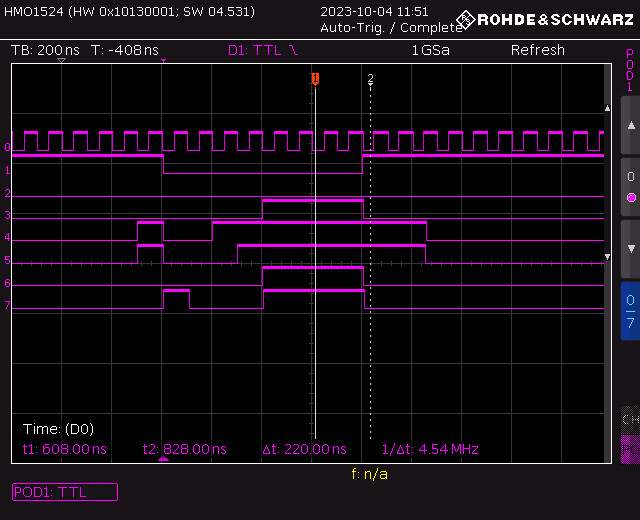

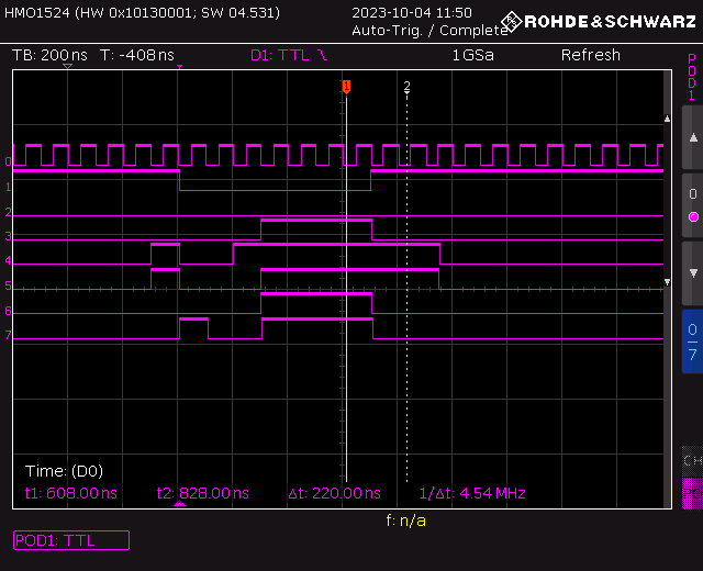

This is the effect of triggering a FlexSPI write at address 0x08 with a 4-byte data value 0xFFFFFFFF. The signals are as expected:
SPI clock frame(s)Value on MOSI linesComment
00x01
Created by kFLEXSPI_Command_SDR LUT entry with operand 0x01
1-20x0008Two address bytes 0x0008 created by
kFLEXSPI_Command_RADDR_SDR LUT entry with operand 16
3-60xFFFFFFFFFive least significant bits of writing 4-byte value 0xFFFFFFFF with
kFLEXSPI_Command_WRITE_SDR LUT entry
But only roughly half the write transactions look like this. More often the transaction looks like this:
Here we have the following:
00x01Correct command 0x01
1-20x0008Correct address 0x0008
30x0CIncorrect frame that must not be present
4-70xFFFFFFFFCorrect 4-byte data value 0xFFFFFFFF
Note that it is reproducible that always the value 0x0C is inserted. I did not see any other value in my tests.

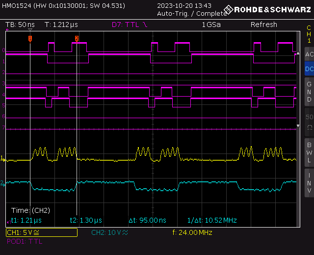

When I observe the transaction at 10 MHz SPI clock frequence with an oscilloscope that also has eight logic analyzer channels, I see the following:
FlexSPI AHB Write Transaction at 10 MHzFlexSPI AHB Write Transaction at 10 MHz
Note that the upper eight purple signals from the logic analyzer are slightly delayed compared to the two analog signals at the bottom, because there are opto couplers in the way. The analog signals are captured from different pins on the board without opto couplers in the way.
The following signals are shown:
Signal Description
purple 0 SPI clock (logic analyzer)
purple 1SPI chip select (logic analyzer)
purple 2-76 least significant bits of SPI MOSI (logic analyzer)
yellow 1SPI clock (analog channel)
blue 2SPI chip select (analog channel)
The cursors measure the length of the analog SPI chip select signal at the bottom, which is exactly 700 ns. This corresponds to the seven clock cycles at 10 MHz, and this is the expected result according to the LUT entries.
This is the corresponding screenshot for running the otherwise identical program with 100 MHz:
FlexSPI AHB Write Transaction at 100 MHzFlexSPI AHB Write Transaction at 100 MHz
The purple signals of the logic analyzer obviously are no longer reliable, apparently the opto couplers on the board can't keep up anymore.
But with the analog two signals at the bottom we see the following:
  • The measurement of the SPI chip select low phase at the bottom reads 95 seconds (blue signal 2). If it was seven cycles at 100 MHz, it should take approx. 70 ns.
  • The SPI clock pauses apparently for two cycles after the first three cycles (yellow signal 1).
This is the core of the problem: The FlexSPI engine inserts two dummy cycles on its own, although no dummy cycles are specified in the FlexSPI LUT sequence for the write transaction. The transaction takes nine cycles although it should take only seven cycles. This does happen with an SPI clock frequency of 100 MHz but not with an SPI clock frequency of 10 MHz.
There's nothing we can do about this in software, except from how the FlexSPI engine is configured. This is the configuration of the FlexSPI engine that we use:
