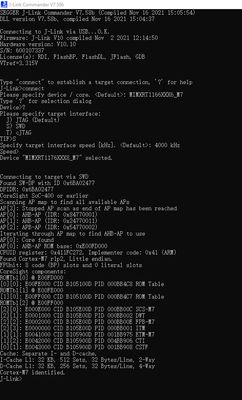

    Please don't use the IDE at first, your picture mentioned .cfx in the MCUXpresso IDE, it is used for the CMSIS DAP debugger, not the JLINK.
  Please use the JLINK commander to check it at first.
   I mean,  this one:
Then try to connect it.
The correct result should like this :
If you even can't find the Cortex m7 core, it means your hardware have issues, even not related to the QSPI, you need to check the hardware, the POR sequence, etc.
Wish it helps you!
kerry
9,938 Views
ManikantaRobbi
Hi Kerry,
Thanks done as per your instructions using J-link commander. Getting MIMXRT1176 CM7 core identified but using loadfile command to flash bin file after connecting, error message -
Kindly do the needful.

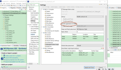

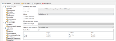

ManikantaRobbi
Yes this procedure is working, but when we disable check box Link Application to RAM -again it is throwing error. And we are testing the application using Boot switches-Internal Boot mode

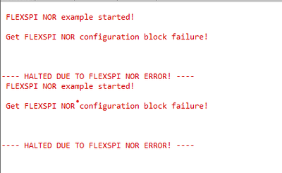

ManikantaRobbi
Thanks Kerry,   these are the changes done but we are not getting unexpected output.

kerryzhou
Hi @ManikantaRobbi ,
   Your printf log is tested from internal boot, and run in internal RAM, right?
  The printf log is not correct, it means your QSPI flash operation is not passed.
  Please help to check your board, whether the flexSPI DQS pin is float or not?
Kerry

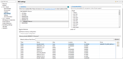

ManikantaRobbi
Thanks Kerry,
Tried as you suggested, but getting error message
and our Hyperflash is S26KL512S  not as same vendor  present on EVK kit MX25UM51345GXDI00
 but I can't find any dropdown to select .cfx file for S26KL512S  part number as shown in below Image.
9,814 Views

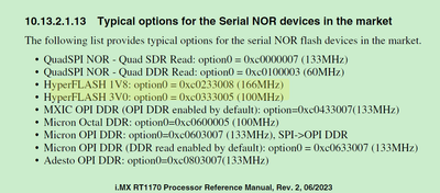

kerryzhou
   Seems your hardware have issues if you can't make it work.
   Please note, MX25UM51345GXDI00 is not the hyperflash, it is octal flash.
  That's why I recommend you use the hyperflash:
• HyperFLASH 1V8: option0 = 0xc0233008 (166MHz)
• HyperFLASH 3V0: option0 = 0xc0333005 (100MHz)
   Which one you have tried?  You also need to do the correct BOOT_CFG pin configuration.
You also can refer to the RT1050-EVKB,as that board is using the hypeflash in default.
Kerry

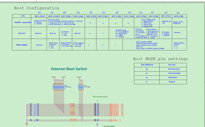

ManikantaRobbi
Thanks Kerry,
I tried to change the BOOT_CFG pins i.e. 2 and 3 pins but its has only four options
FLASH_PROBE_TYPE
0 - QuadSPI NOR
1 - MXIC Octal
2 - Micron Octal
3 - Adesto Octal
How to enable no hyperflash option is visible.
9,799 Views

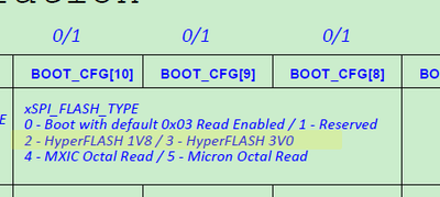

kerryzhou
  Mainly these BOOT_CFG:
Kerry
