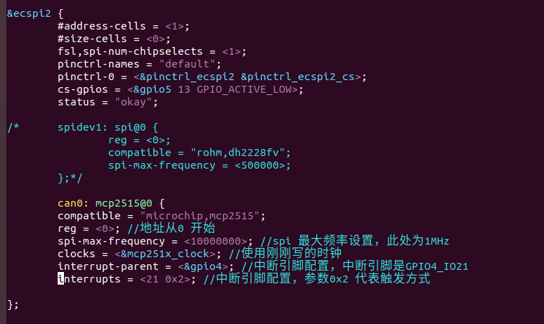

I am using imx8mp and I am using version 5.4.70。
My demand is three can, there were two on the development board, now I use spi to can method, add a new can, I use the chip is 2515, the driver kernel source code contains 2515 driver, but spi to can chip out of the can node number is not fixed。
Here's an example:
SPI to CAN corresponding software node: can1;
Software node of CAN1: can0;
CAN2 Software node: can2.
But if I start here, it will become the following situation:
SPI to CAN corresponding software node: can2;
Software node of CAN2: can1.
Therefore, I would like to ask if there is any way to make the node number from spi to can fixed as can2.
My dts configuration is as follows:Image_20231127115311.png
