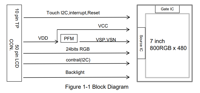

Hi @kerryzhou ,
We're working on a custom RGB888 display. The wiring diagram and signal format can be seen in the photos below. We have a few questions about this. Exactly which GPIO will be adapted here. Will we do GPIO set and reset operations on the LCD low level side? Will we control it by setting a separate timer?
Thank you again.

Hi @tbayram ,
   After checking your situation, I think you don't need to use the GPIO, you can use the DE to connect to LCD_ENABLE pin.
Kerry

Hi @tbayram ,
  As it is the LCD, it is the output, so, if you don't use the HYSNC and VSYNC, just don't connect it, but you still need to connect the DE which is LCD_ENABLE.

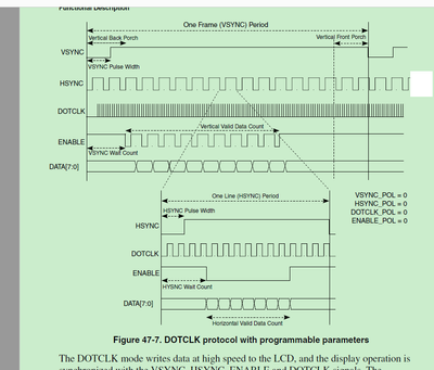

  RT1176 RM is the best document:
https://www.nxp.com/webapp/Download?colCode=IMXRT1170RM
 Chapter 47.3.3 DOTCLK Interface
Wish it helps you!
Kerry

  In fact, this is also easy to realize, you just need to define one GPIO for your used DataENABLE ,then use the GPIO to control that pin to match your used LCD time sequence.
  To the LCDIF, you do not need to connect HSYNC and VSYNC pins, as your LCD don't need it.
