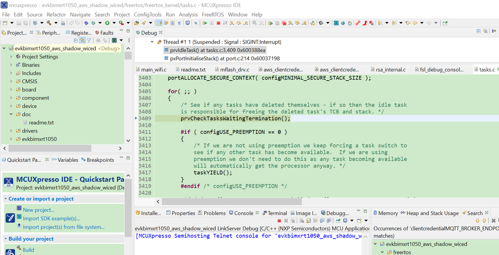

I am getting same faults when I try to debug the shadow sample. I have following questions:
  • All the faults are in mflash_drv_write_page_internal function which disables interrupts at the beginning and as soon as it re-enables interrupts, there is a fault. Sometimes it a memfault and sometimes it is a bus error. Does it ring any bell?

When I comment out the #ifndef XIP_EXTERNAL_FLASH check from mflash_drv_init_internal function in file mflash_drv.c, I no longer get these faults.
I see that this check does not exist here: https://github.com/NXPmicro/amazon-freertos/blob/feature/v1.4.7-nxp-support/lib/third_party/mcu_vend...
Can someone from NXP confirm if it is the right solution?

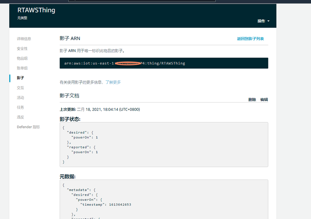

  Today, I test the newest SDK2.9.1 code for the RT1050, but I didn't meet the fault issues which you mentioned.
  These are my test result, you can find my code is working, and the shadow is updated in your AWS webpage:

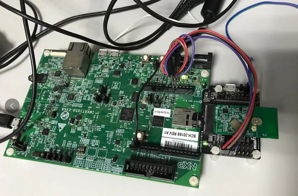

I tested for a lot of times with the original SDK evkbimxrt1050_aws_shadow_wiced code in SDK2.9.1 , and I also add my :
- Murata 1DX M.2 module
- Murata uSD M.2 Adapter
So, if you have time, could you please check the newest SDK, whether you can meet the faults or not?

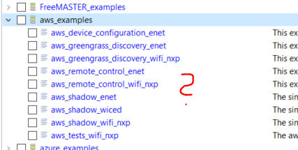

I installed MCUXpresso 11.3.0 and SDK 2.9.1 but there isnt any aws_remote_control_wiced anymore. What do I wrong?
