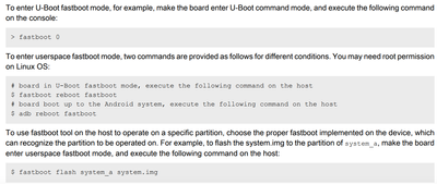

Zhiming_Liu
Please try to enter uboot fastboot mode:
