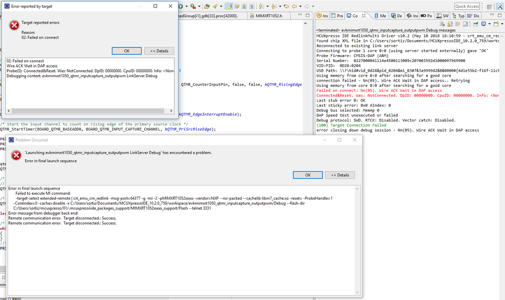

Failed to execute MI Command:

I build and debug NXP examples fine on IMXRT 1050 dev board, if I disconnect the board every single time before debugging. Next I terminate debug mode, i change the code,build, and debug without disconnecting the board and get this error.

igorpadykov
Hi Steven
such error usually happens when previous debug session was not terminated propely,
one can check suggestions for this on:
GDB Debugging with Kinetis Design Studio
igor

sortiz
This document was very useful for debugging, yet I had the same error.
This update is for future people that may have the same problem. I had version v10.2.0_759.
I resolved the issue with installing a new MCUXpresso Verision- v10.2.1_795.
Thank you,
