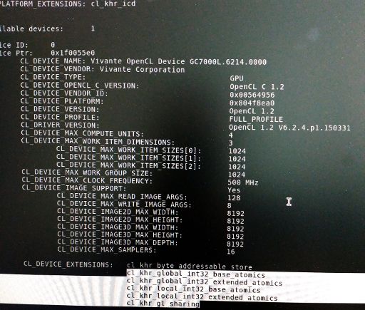

Just got imx8mq EVT board and did run clinfo tool on it. I was really disappointed that OpenCL on it does not have FP16 arithmetic support.

Currently there is no support of cl_khr_fp16 and cl_khr_spir extensions in the OpenCL 1.2 driver (the current driver). I would recommend contacting Vivante to have more details of the hardware capabilities for FP16 support and to request more information on how to enable it.
