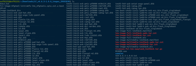

@Manuel_Salas  I didn't found any libethosu_delegate in /usr/lib.I am attaching the output for your reference.

Manuel_Salas
Hello @Mohan51
Did you flashed the full image from our official BSP?
Best regards.
Salas.
6,764件の閲覧回数
Mohan51
@Manuel_Salas yes I flashed the full image.and i downloaded the image from this url(https://www.nxp.com/webapp/sps/download/license.jsp?colCode=L6.6.3_1.0.0_MX93&appType=file1&DOWNLOAD...) i.e IMX93 EVK QSB.
6,761件の閲覧回数
Manuel_Salas
@Mohan51 I downloaded the same image as you and I did this procedure:
In the directory you will find these files:
To flash the full image you can set the command:
$sudo uuu -b emmc_all imx-boot-imx93evk-sd.bin-flash_singleboot imx-image-full-imx93evk.wic
Boot the board.
Finally:
Best regards.
Salas.
