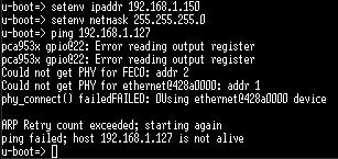

I'm tryng to test Ethernet interface on a custom board, similar to IMX93QSB. The big difference is the physical Ethernet, that in my case is ADIN1200 while iMX93-QSB uses RTL8211. Since I don't have a custom Linux image yet, I loaded imx-boot-imx93-11x11-lpddr4x-evk-sd.bin-flash_singleboot on my board hoping that U-boot ping command could help me.
First of all I use the command: mii info to see whether the chip is recognized and everything seems to be ok:
then I tried to read and write on ADIN1200 registers and these commands work without problems (for example I can change LED_link_status with the command mdio write 1c 0x210E).
Then I did:
-setenv  ipaddr 192.168.1.150
-setenv  netmask 255.255.255.0
-ping 192.168.1.127 (my pc host)
And at this point nothing seems to work! Not even the Link-up LED works when I connect the devices with the cable (both pc side and board side), it is like unconnected.
Do I need to change some configurations to, at least, see the correct functionality of the link-up or Ethernet PHY should be sort of plug and play in terms of link-up? By the way, I'm sure that the cable is ok! Please help me understand.
Thanks in advance,
Bob

JosephAtNXP
Thank you for your interest in NXP Semiconductor products,
You need to port the PHY address, the eqos is looking for an specific PHY. Changes are required in board.h.
https://github.com/nxp-imx/uboot-imx/blob/lf_v2022.04/include/configs/imx93_qsb.h#L195-L200

Bob_NXP_user
Hello @JosephAtNXP ,
Now I'm able to generate new bootloader starting from the one NXP provides. I changed the following uboot file:
/include/configs/imx93_evk.h (uboot-imx/include/configs/imx93_evk.h at lf_v2022.04 · nxp-imx/uboot-imx · GitHub)
I modified DWC_NET_PHYADDR to 0 (from 1)
Since I'm using imx93 11x11, it fit better then imx93_qsb. Unfortunately It still doesn't work, there is no link-up between the board and the host pc. I have done the same steps using iMX93-QSB board and I achieved link-up and ping succesfully, so I'm pretty sure that the procedure and the cable are ok.
It is the change of PHY Address enough to use ADIN1200 instead of RTL8211 in U-Boot?
Please, let me know something, it is very important.
Bob

JosephAtNXP
Please run the following commands at U-boot
=> pri ethprime
=> mdio list
=> mdio read <bus output> 0 0
=> mdio read <bus output> 0 1

Bob_NXP_user
This is what I see running these commands:
Please, let me know your thoughts.
Thank you,
Bob
921 Views
JosephAtNXP
The PHY is not getting detected, there is an error that has not been spotted yet.
1. Confirm that MDIO HW complies with pull up design, if possible, probe the bus.
2. Verify that you have the correct PADs set for MDIO in your DTS.
3. Confirm that you DTS has the correct PHY address.
4. Issue the commands
=> mdio read ethernet@428a0000 0 0
=> mdio read ethernet@428a0000 0 1
1,094 Views
