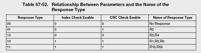

  Parameters of C-function card_cmd_config() are used to fill bit fields of Command Transfer Type
(uSDHCx_CMD_XFR_TYP)  register. Your pattern (1<<0)|(1<<2)|(1<<4) concerns the following
bit fields :
- CICEN (Command Index Check Enable) ;
- CCCEN (Command CRC Check Enable) ;
- RSPTYP[1:0] (Response Type Select).
The table below from the i.MX6 Reference Manual shows meaning of possible settings.
The last two parameters of C-function card_cmd_config() are used to configure
CICEN and CCCEN. Perhaps it would be better  to change them.
