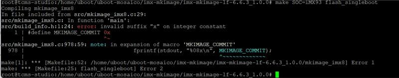

When it comes to run the command:
make SOC=iMX93 flash_singleboot
The output gives the following error:
Can anyone help me with this issue? I can't figure out what is going on.

Harvey021
Hi @Bob_NXP_user
It seems that the commit number has not been generated. please make sure your download. Have a run "git rev-parse --short=8 HEAD >> src/build_info.h" to see what it is.
Harvey

Harvey021
This seems to be a problem with your git.
or did you download the imx-mkimage in git clone?
Harvey

I tried to do the gitclone command as you suggested:
git clone https://github.com/nxp-imx/imx-mkimage.git
The download terminated succesfully, then I moved all the necessary files into iMX93 folder. Then I execute:
this command returns:
How can i go ahead?
Bob

Harvey021
This is another issue missing DDR firmware.
Follow the steps as below.
wget https://www.nxp.com/lgfiles/NMG/MAD/YOCTO/firmware-imx-8.23.bin
chmod +x firmware-imx-8.23.bin
./firmware-imx-8.23.bin
copy missing ddr firmware from -> firmware-imx-8.23/firmware/ddr/synopsys/
Harvey
1,816 次查看
Bob_NXP_user
Thank you, now it works!
