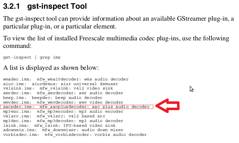

I'm trying to enable the enhanced aac plus decorder on an i.mx6 solo board using the freescale ubuntu oneric release.
And followed the steps indicated in the “i.mx6 Series ubuntu Multimedia User’s Guide” located in:
The manual indicates that I should see:

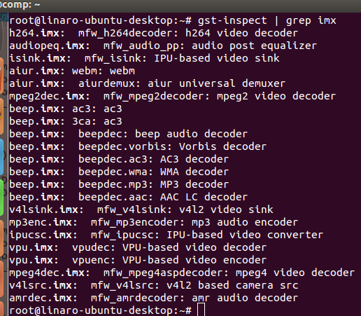

However I don't see it in my list:

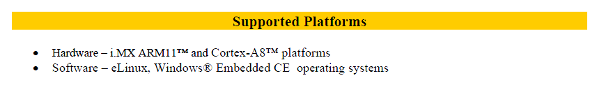

But then I noticed something interesting as I  continued to read the "Enhanced aacPlus Decoder Product Data Sheet"
which states that only arm11 and Cortex-a8 are supported ( We’re using an i.mx6 – cortex a9 )
Then I saw a question on Freescale Community which seems to confirm this - https://community.freescale.com/thread/312433
( By the way, I did try deleting the .gstreamer-0.10 directory and re-running gst-inspect just in case but it didn't help. )
Any suggestions would be great as I've reached a wall and am unsure of where else to look.

Freescale AACplus decoder is included in special package.
It is stated in i.MX6 Series Multimedia Release Notes. So,
please contact marketing to get it.
