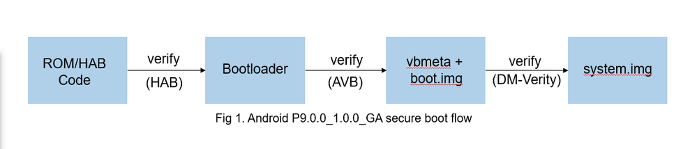

joanxie
yes I think so, pls see the pic as below:
give an example of P9.0.0_1.0.0:
The AVB is already enabled by default in Android P9.0.0_1.0.0_GA for i.MX8MM EVK board.
The support is enabled/disabled by modifying BoardConfig.mk file located  at ${MY_ANDROID}/device/fsl/imx8m/evk_8mm:
BOARD_AVB_ENABLE := true
Once this configuration is enabled the Android project creates vbmeta.img which will contain a hash descriptor for boot.img, a hashtree descriptor for system.img, a kernel-cmdline descriptor for setting up dm-verity for system.img and append a hash-tree to system.img.

pratik_manvar
Hi joanxie‌,
Yes you are right. We also got below clarification from NXP Team.
"The dm-verity key is used for old Android OS which doesn't has AVB support.  It is not used for the system which has AVB function, vbmeta binary has the root hash and vbmeta is signed with AVB private key to make sure the integrity of the root hash."
