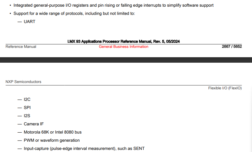

Thank you for your interest in NXP Semiconductor products,
You could use one of the predefined protocols that flexIOs works with, use the rising/falling control or use a simple GPIO code to manage your interface. Those 3 options are suitable for i.MX MPUs.
