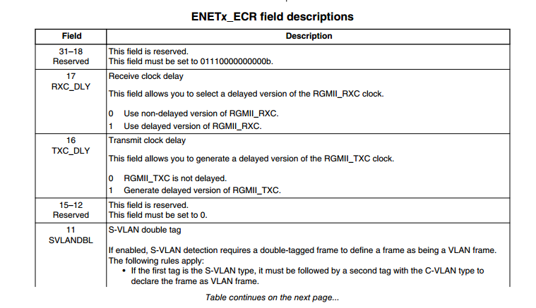

I'm using i.MX6SoloX and have a question about RGMII interface.
I want to set RXC_DLY and TXC_DLY field of ENETx_ECR register and try following flow.
But both fields aren't able to set "1".
The BSP is L4.1.15 and the tool which I used is memtool.
Here is my tried flow and the result.
root@imx6sx_all:/unit_tests# ./memtool -32 02188024=70030012
Writing 32-bit value 0x70030012 to address 0x02188024
root@imx6sx_all:/unit_tests# ./memtool -32 02188024 10
E
Reading 0x10 count starting at address 0x02188024
0x02188024: 70000012 00000000 00000000 00000000
0x02188034: 00000000 00000000 00000000 611215E1
0x02188044: 0000001A 00000000 00000000 00000000
0x02188054: 00000000 00000000 00000000 00000000
Also I read a P1098 of reference manual.
It seems that RXC_DLY and TXC_DLY can set "1".
Can RXC_DLY and TXC_DLY set to "1" ?
If yes, please tell me how to do.

RXC_DLY and TXC_DLY fields are not functional in any i.MX6SX releases.

However, I tried same way with MCIMX6X-SDB.
Do you mean that it depends on the device revision ?
According to the latest datasheet, user can set 16 and 17 field.
Ko-hey

  I expect it may work only for the rev.1.3 : mask 3N19K

Okay, so the conclusion is as follow.
Rev 1.2 ?Production (Maskset 2N19K)                         ENETx_ECR can't overwrite.
Rev 1.3 ?Production (Maskset 3N19K)                         ENETx_ECR can overwrite.
Is it correct ?

Yuri
  From the team :
" i.MX6SX doesn't have that feature".
Yuri.

Yuri

The same seems to be true for iMX6Q?
System Information
Processor                          = iMX6 Quad (4 cores)
Speed grade                        = 996 MHz (core @ 996 MHz)
Temperature grade                  = Automotive -40 to 125C
Chip silicon revision              = 1.3
\> memtool 0x2188024=0xF0030112
Writing 1 DWORD(s) to physical address 0x2188024...
Reading 1 DWORD(s) from physical address 0x2188024...
0x02188024:  F0000112
As you can see, ENET_ECR[17:16] also don't stick in the iMX6 Quad. I guess these bits are non-functional in all iMX variants?

  request for the Reference Manual correction was added.
