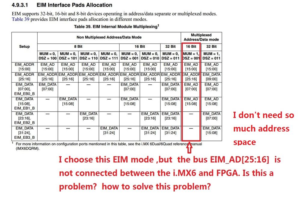

I want to simply the  ADDRESS bus.  Please check the picture below.

  It is not a problem (to leave floating high address lines) if these signals
are not used in Your device, connected to the EIM. Address range is defined
by CS. Please refer to Table 2-1 (System memory map) and section 22.4 (Chip
Select Memory Map)  of the Reference Manual.  CS must be used.
Note, address range will be restricted by low 16 bit.
