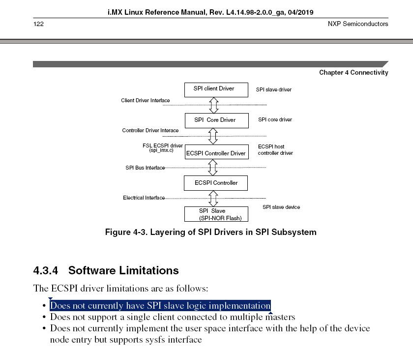

one can check ERR009535 ecspi slave erratum in
Chip Errata for the i.MX 6ULL
Software support is described in Linux L4.14.98_2.0.0 Documentation
igor
4,276 Views
chris_f
Contributor V
I'm using a custom kernel driver because slave mode was not implemented yet.
Seems there is a HW problem that for some reason is still not mentioned in the errata. This is from six years ago:
TX Issue on i.MX6 ECSPI (Slave)
Is this described anywhere? Is there a work-around without using DMA?
