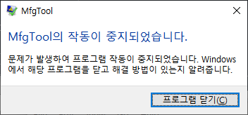

Then, when boot up the board, Windows 10 installs the (Freescale SE Blank PELE) driver, but the MFG Tools are forced to terminate.
LOG : MfgTool_Crash.log
Question. How can I download binaries to SDCard on the MCIMX6SX-SDB board using MfgTool?

I did the following, but I have a problem.
1. mode change
2. Run the MFG_Tool
3. Power on the EVB board.
4. The MFG_Tool is terminated...
2~4. screen capture : http://shorturl.at/acmLP
What are the differences causing this problem?
Please give me your opinion.
I appreciate it.
⨁ add contents : It works on other computers. it is the problem that only happens on my computer. In relation to that, is there anything wrong?

I tested it under various conditions.
ComputerOSResult
DesktopWindows 10problem occurrence
NotebookWindows 7normal operation
VMWareWindows 10problem occurrence
VMWareWindows 7normal operation
VMWareWindows 8.1problem occurrence
As shown in the table above, it seems to be the problem in Windows 10 & 8.1.
Windows 7 works fine.
Can you confirm the status quo?
I appreciate it.
⨁ add contentsThere is also the forced shutdown problem in Linux.
The tested version is Ubuntu 12.04.3, 14.04.5, 16.04.6, 18.04 LTS.

Hi, Joan Xie.
I got several windows 10 and tested them.
But it doesn't work.
Do you have a driver for Windows 10?
There is an event that failed migration in HID.
Please check again.
Thanks.
ps. The specification of my Windows 10 is "Windows 10 Pro / 1909 / 2020-02-24 / 18363.900"
⨁ add contents : The migration was resolved with the "sfc/scannow" command, but the MFGTool problem is not solved.

Hi, Joan Xie.
MFGTools2 problem is not improved.
I think, it's a window 10 problem.
uuu is fine, so I'm using uuu instead of MFGTools2.
Thanks.
