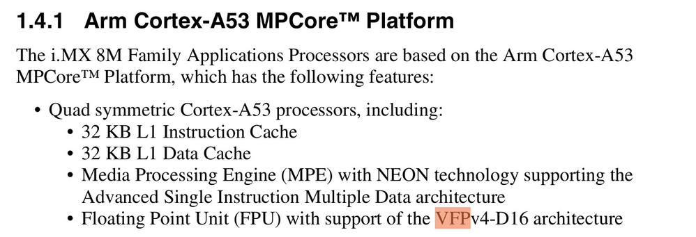

Hi community:
  Does the imx8mq chip support hardware floating point arithmetic?
1,113 Views
joanxie
yes, supports it, refer to the yocto user guide:
All packages which are released as binary are built with hardware floating point enabled as specified by the
DEFAULTTUNE defined in each machine configuration file.
