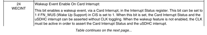

     I have one question about this SDIO wakeup using DAT1 line, does the SDIO need clock to be on when waiting for this wakeup interrupt? As when suspend, there is no SDIO clock available. If no need SDIO clock, the DAT1 line's level change can trigger our SDIO interrupt, then I think this feature should be feasible.
6,476 Views
raymondwang
Senior Contributor I
    I'm not familiar with SDIO spec, but I guess that no sdio clock required when device suspended.
I found the uSDHC controller should support that but driver never touch it. Below is a snapshot from uSDHC
uSDHCx_PROT_CTRL.

AnsonHuang
I think you may need to ask SDIO owner for that, from kernel side, as long as GPC can receive interrupt from SDIO, system should be able to resume.
