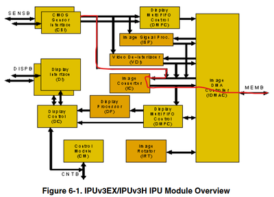

In the i.MX6 there seemed to have been a direct access route between the CSI receiver and the system memory:
See figure 6-1 in IMXLXRM Rev. L4.9.88_2.0.0-ga, 05/2018.

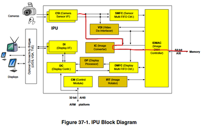

The newer i.MX6 reference manual also shows this path:
See figure 37-1 in IMX6DQRM Rev. 6, 05/2020.

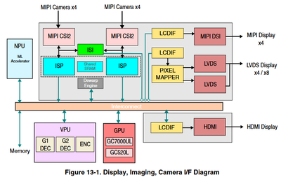

On the i.MX8MP there seems to be no direct way from CSI to memory:
See IMX8MPRM Rev. 3, 08/2024.
Data from the CSI port must pass through the ISI to get to memory.
