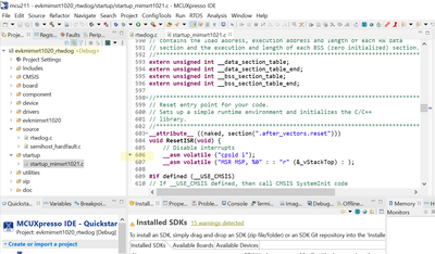

  Do you try to add a breakpoint at the rest handler, whether that works when the RTWDOG reset happens?
   Do you test the SDK code directly when the reset happens?
  Please try it again, you also can share some debug screen to demonstrate your issues.

What is the rest handler for? I mainly had issues in running the debug console. Each time the RTWDOG reset the MCU, the debugger paused. Even when I flashed my program to my dev board and gave it power, upon reset it did not begin re-running the program

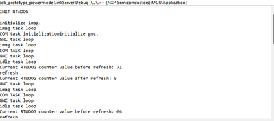

Hi Kerry, so this is my output on the debug console when refreshing the RTWDOG every certain period of time. I use a print statement before and after the refresh to confirm that the rtwdog is behaving as expected and that the counter is incrementing.
However, this is my result when I turn off the refresh and force the rtwdog to reset the mcu. As you can see, my code just sort of stops running, essentially shutting down, and does not reset and re-initialize the program. The counter does increment and it resets at the value that I expect it to. My current debug mode is "Debug using LinkServer probes"
Is there perhaps a different debugger I can use? And yes you said it completely right. The code does not print any more information after resetting the MCU. I expect it to essentially print out the exact same messages, which it does not do. Any help would be great, thanks!

   If you just download the code which didn't refresh the RTWDOG to the flash, then run it directly, whether it can reset or not? I mean, don't use the debugger.

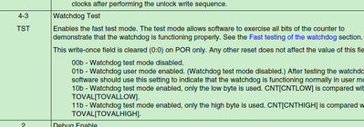

   From your attached picture, seems your RTWDOG counter still increase, whether it is not reset?  If yes, just the debug mode meet issues, check this bit:
You need to set DBG=1 when debug.
Wish it helps you!

Should I set enableStop and enableWait to be low and enableDebug to be high? This is my current config:

To debug it in MCUX do I need to also enable test mode bit to be high, or just debug and ignore wait/stop?

  If you need to run in the low power mode, then you need to enable:enableStop and enableWait
  I think, you can enable all of them, as it won't influence your normal work.
  You don't need to enable the test mode.
