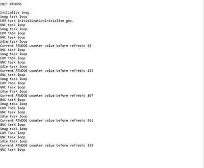

Currently, I have what I believe to be functional code implementing the RTWDOG. However, when I run the debugger on MCUXpresso, my code stops when I expect it to be at the set timeout value. But when the MCU supposedly resets, my debugger pauses and waits for me to manually resume it so that it runs the program again. How can I properly debug my RTWDOG so that it automatically resets the MCU and runs on its own without me having to forcefully resume it in the debugger? Is there perhaps a different debug mode I should be aware of? Currently, my watchdog is configured to have waitMode on, debug and stop mode off. However, even when I enable debug mode I get the same results. Any tips would be greatly appreciated, thanks!

Hi Kerry, so this is my output on the debug console when refreshing the RTWDOG every certain period of time. I use a print statement before and after the refresh to confirm that the rtwdog is behaving as expected and that the counter is incrementing.
However, this is my result when I turn off the refresh and force the rtwdog to reset the mcu. As you can see, my code just sort of stops running, essentially shutting down, and does not reset and re-initialize the program. The counter does increment and it resets at the value that I expect it to. My current debug mode is "Debug using LinkServer probes"
Is there perhaps a different debugger I can use? And yes you said it completely right. The code does not print any more information after resetting the MCU. I expect it to essentially print out the exact same messages, which it does not do. Any help would be great, thanks!

   If you just download the code which didn't refresh the RTWDOG to the flash, then run it directly, whether it can reset or not? I mean, don't use the debugger.
   From your attached picture, seems your RTWDOG counter still increase, whether it is not reset?  If yes, just the debug mode meet issues, check this bit:
You need to set DBG=1 when debug.
Wish it helps you!
