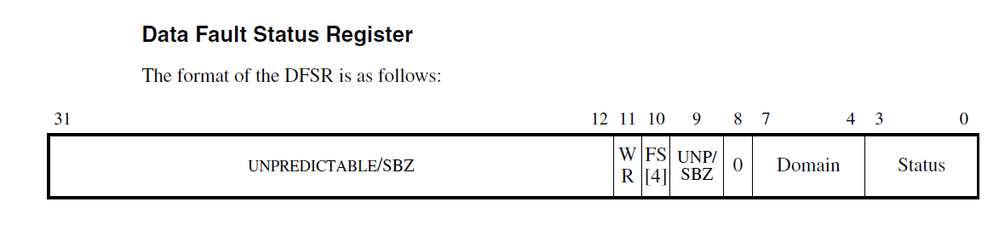

Question 2
The ARM manual describes the DFSR encoding as - Bit fields [11,10,3:0]. 11th bit -> read/write
However the DFSR value - 0x1406 has 12th bit set. Which according to manual is undefined. I need to know what is the implementation in i.MX6.

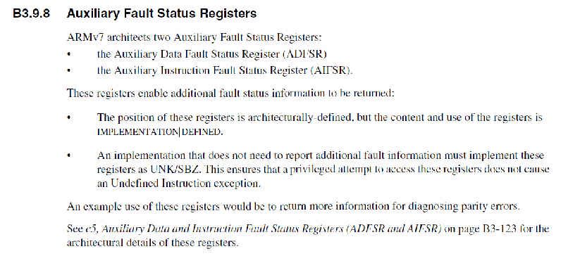

ARM documentation does not specify the detailed bit fields and it says that
it is up to the chip vendor to decide and design, what goes into the
register. Typical implementation would include details about source of
external abort. But this info is not captured in i.MX6 TRM.

niranjandighe
I am referring the ARM v7 Architecture Reference Manual, page number -
1327, setction B3.9.8.
Please find the snapshot below -
Niranjan Dighe
On Tue, May 19, 2015 at 2:47 PM, igorpadykov <[email protected]>
4,489 Views
igorpadykov
Hi Niranjan
attached part of document says:
"contents.. of registers is IMPLEMENTATION defined"
that is content may depend on processor architecture: Cortex A5,A9
e.t.c. nothing said about chip vendor.
igor
