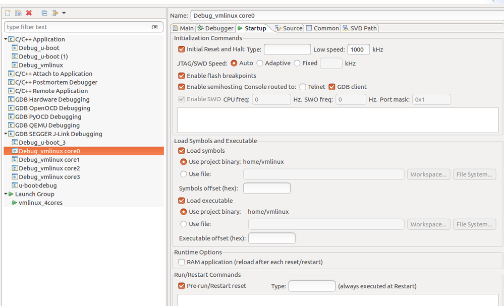

Hi All,
My custom hardware is iMAX6Q processor based and similar to Nitrogen 6 max.
I'm referring to this link >> Debugging using Segger J-Link JTAG - Boundary Devices https://boundarydevices.com/debugging-using-segger-j-link-jtag/https://boundarydevices.com/debugging-using-segger-j-link-jtag/

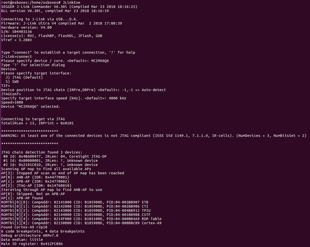

1) In which boot mode we need to set the board when we are doing the kernel debug ? Do we need to load kernel via SD card ?

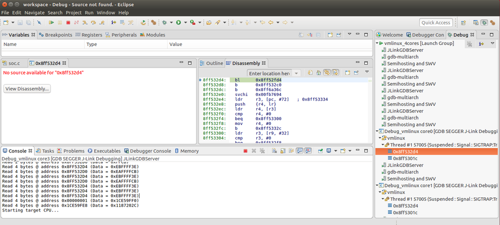

2) First I connected target hardware to JLink. Why it is showing No source available for 0x8ff532d4 ? Canyou see any mistake in following configurations. ?

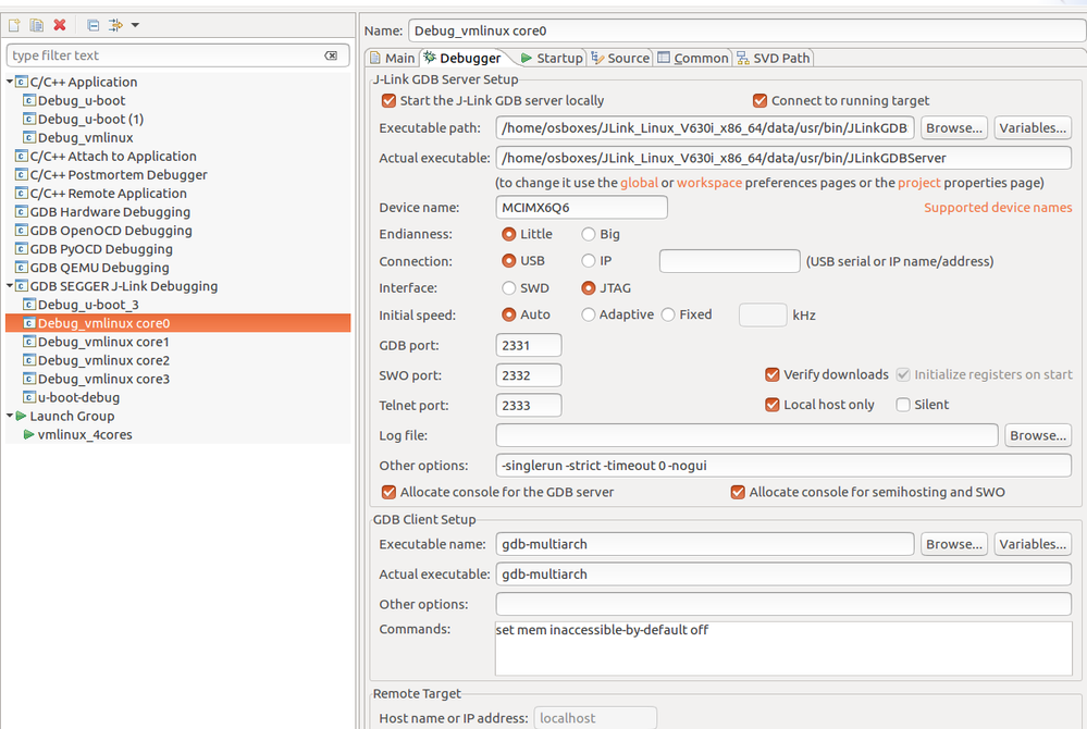

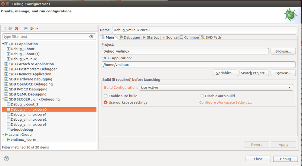

Next ran the Eclipse.

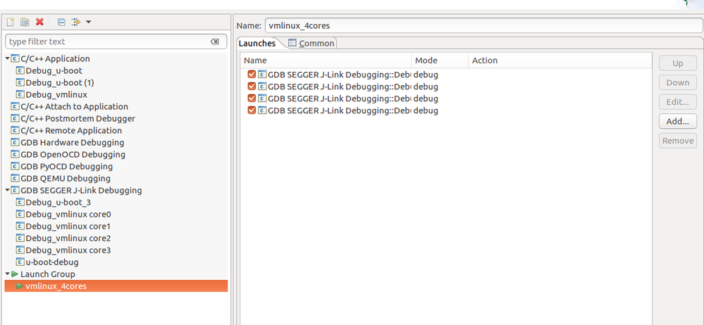

Debug configurations as follows.
Launch Group as follows.
When I hit Debug I got following results.
Here is the Console log. >>

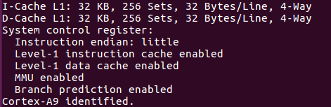

Connecting to target...WARNING: At least one of the connected devices is not JTAG compliant (IEEE Std 1149.1, 7.1.1.d, IR-cells). (NumDevices = 3, NumBitsSet = 2)
J-Link found 3 JTAG devices, Total IRLen = 13
JTAG ID: 0x4BA00477 (Cortex-A9)
Connected to target

Received monitor command: regs
PC = 8FF532D4, CPSR = 600001D3 (SVC mode, ARM FIQ dis. IRQ dis.)
R0 = 00000000, R1 = 8FFBA1C1, R2 = 00000000, R3 = 00000001
R4 = 8FFB7694, R5 = 00000000, R6 = 8FFB9FAF, R7 = 00000001
USR: R8 =8FFA1298, R9 =8F335ED0, R10=8FF9269A, R11 =00000001, R12 =00002814
R13=00000000, R14=00000000
FIQ: R8 =00000000, R9 =00000000, R10=00000000, R11 =00000000, R12 =00000000
R13=00000000, R14=00000000, SPSR=D0010BB0
SVC: R13=8F335D88, R14=8FF5301C, SPSR=A20444BB
ABT: R13=00000000, R14=00000000, SPSR=80041A0C
IRQ: R13=00000000, R14=00000000, SPSR=8000902D
UND: R13=00000000, R14=00000000, SPSR=40030403
Reading all registers
Read 4 bytes @ address 0x8FF532D4 (Data = 0xEBFFFF3E)
Read 4 bytes @ address 0x8FF532D0 (Data = 0xEAFFFFCB)
Read 2 bytes @ address 0x8FF532D4 (Data = 0xFF3E)
Read 2 bytes @ address 0x8FF532D2 (Data = 0xEAFF)
Read 2 bytes @ address 0x8FF532D0 (Data = 0xFFCB)
Read 4 bytes @ address 0x00000001 (Data = 0x1CE59FF0)
Read 4 bytes @ address 0x1CE59FE8 (Data = 0x1187202C)
Starting target CPU...

  Please look at my comments below.
1.
  Use Serial (USB) downloader mode for JTAG debugging; perform memory init
script and try to run bootloader (U-boot) and / or kernel under JTAG.
2.
  Linux applications may be debugged, using the GDB, without JTAG, assuming applications
are built with debug support.

I must be thankful to you if you can guide me on this issue. Are there any methods for hardware debugging to pinpoint the issues related to this while running applications on linux ?
Peter.
4,108 Views
Yuri
  perhaps the following helps:
https://community.nxp.com/message/1011385
Yuri.
