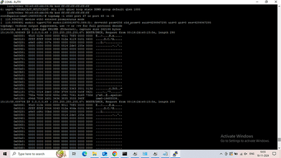

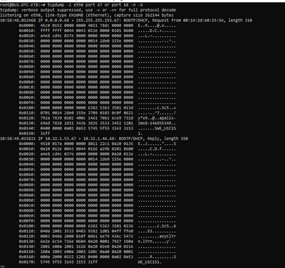

Hello Community,
I’m using the Apalis iMX8 QuadPlus with Yocto Dunfell on our custom board. While the unit generally functions well, there are times when it fails to obtain an IP address from the DHCP server. We’ve used tcpdump on both the server and client sides for analysis. The client continuously sends DHCP Discover packets, which the server receives and responds to with DHCP Offer packets. However, these Offer packets are not visible on the client side. As a result, the client keeps sending additional Discover packets, causing the process to stall and preventing it from acquiring an IP address. This situation persists until the unit is power-cycled or the eth0 interface is brought down and then back up.
Client Side
Client_Broadcasting_DISCOVER_Message1366×768 69.4 KB
Server Side
Server_Replying2Discover_OfferWithUnicast719×678 15.1 KB
Any guidance on resolving this issue promptly would be greatly appreciated.
