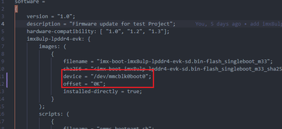

when I try to upload M core in the bootloader with dtb file and kernel image on
mmcblk0boot0
while booting I am getting dtb file not avilable error, so It is not able to boot further.
How can I ensure that am I flashing in the correct partition or not and do I need to update dtb, kernel and M core image on the same partition or in different partition in sw-description file.
How sw-description file will look like in this case and what will be partition scheme for imx8ulp-evk9 that's main thing I want to know.

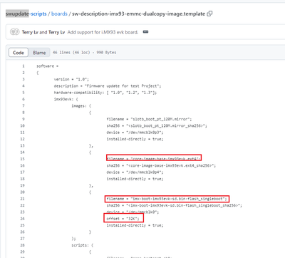

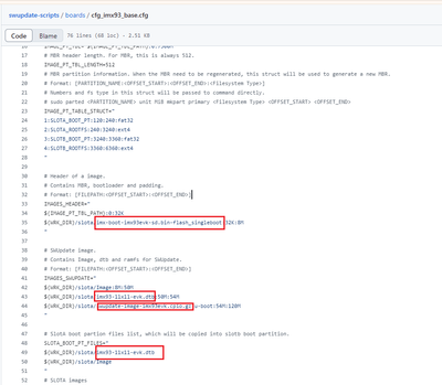

Zhiming_Liu
The file you need to update is not in /dev/mmcblk0boot0. Please refer the templates in https://github.com/NXP/swupdate-scripts/tree/main/boards.
You can copy config files from i.MX93, the step is replacing file names in these configs.
https://github.com/NXP/swupdate-scripts/blob/main/boards/cfg_imx93_base.cfg
https://github.com/NXP/swupdate-scripts/blob/main/boards/cfg_imx93_update_image.cfg
https://github.com/NXP/swupdate-scripts/blob/main/boards/sw-description-imx93-emmc-dualcopy-image.te...
These names are different, and the offset is same as i.MX93(32K) on i.MX8ULP.

dhruvinrajpura
Thanks @Zhiming_Liu
I created sw-description file as given in reference and attched here as well, with that when I perform swupdate only A core image is updating on the M core image is still previous one after rebooting.
Can you please check my sw-description and script to generate swu file for that?

dhruvinrajpura
Thanks @Zhiming_Liu
It's working fine to update M core image,
For dual copy purpose in the cfg_imx8ulp_base.cfg currently looks like below
#!/usr/bin/bash
# Name of the SoC.
# This name will be used to source this board specific cfg file.
SOC_NAME=imx8ulp
# Used to generate base image.
# Partition table format, MBR or GPT.
IMAGE_PT_TBL_FMT="MBR"
# Path of MBR file. If -m is specified in command option, this file will be regenerated.
IMAGE_PT_TBL_PATH="${WRK_DIR}/common/swu_dualslot_7.5G.pt"
# Information of MBR file. Format is [FILENAME:<OFFSET_START>:<OFFSET_END>]
IMAGE_PT_TBL="${IMAGE_PT_TBL_PATH}:0:7500M"
# MBR header length. For MBR, this is always 512.
IMAGE_PT_TBL_LENGTH=512
# MBR partition information. When the MBR need to be regenerated, this struct will be used to generate a new MBR.
# Format: [PARTITION_NAME:<OFFSET_START>:<OFFSET_END>:<Filesystem Type>]
# Numbers and fs type in this struct will be passed to command directly.
# sudo parted <PARTITION_NAME> unit MiB mkpart primary <Filesystem Type> <OFFSET_START> <OFFSET_END>
IMAGE_PT_TABLE_STRUCT="
1:SLOTA_BOOT_PT:120:240:fat32
2:SLOTA_ROOTFS:240:3240:ext4
3:SLOTB_BOOT_PT:3240:3360:fat32
4:SLOTB_ROOTFS:3360:6360:ext4
# Header of a image.
# Contains MBR, bootloader and padding.
# Format: [FILEPATH:<OFFSET_START>:<OFFSET_END>]
IMAGES_HEADER="
${IMAGE_PT_TBL_PATH}:0:32K
${WRK_DIR}/slota/imx-boot-imx8ulp-9x9-lpddr4-evk-sd.bin-flash_singleboot_m33:32K:8M
# SWUpdate image.
# Contains Image, dtb and ramfs for SWUpdate.
IMAGES_SWUPDATE="
${WRK_DIR}/slota/Image:8M:50M
${WRK_DIR}/slota/imx8ulp-9x9-evk.dtb:50M:54M
${WRK_DIR}/slota/swupdate-image-imx8ulp-9x9-lpddr4-evk.cpio.gz.u-boot:54M:120M
# SlotA boot partion files list, which will be copied into slotb boot partition.
SLOTA_BOOT_PT_FILES="
# SLOTA images
# Contains boot partition and rootfs.
SLOTA_BOOT_PT="${WRK_DIR}/common/slota_boot_pt_120M.mirror:100M:220M"
SLOTA_ROOTFS="${WRK_DIR}/slota/core-image-minimal-imx8ulp-9x9-lpddr4-evk.ext4:220M:3220M"
SLOTA_IMAGES="
${SLOTA_BOOT_PT}
${SLOTA_ROOTFS}
# SlotB boot partion files list, which will be copied into slotb boot partition.
SLOTB_BOOT_PT_FILES="
${WRK_DIR}/slotb/imx8ulp-9x9-evk.dtb
${WRK_DIR}/slotb/Image
# SLOTB images
SLOTB_BOOT_PT="${WRK_DIR}/common/slotb_boot_pt_120M.mirror:3220M:3340M"
SLOTB_ROOTFS="${WRK_DIR}/slotb/core-image-minimal-imx8ulp-9x9-lpddr4-evk.ext4:3340M:6340M"
SLOTB_IMAGES="
${SLOTB_BOOT_PT}
${SLOTB_ROOTFS}
Do we require any modification in this, because we are putting image of M core from 32K should we go from 0:32K for M core image, May be that's why I am getting error to load dt?
