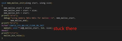

By positioning, I found that it was stuck in a memset() function in the board_init_r() function. So how can I solve it?

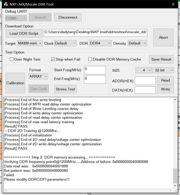

igorpadykov
sorry tab “BoardDataBusConfig” is for LPDDR4. Regarding error in step 2, from log:
Data read was :   0x0000000040001890
But pattern was : 0x0000000040000080
one can check layout (probably there are errors) and check signals with oscilloscope
data bits which are different.

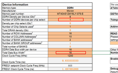

Hi!
Today I adjusted the 32-bit ddr4 to 16-bit, (I don’t know if it’s the high 16-bit or the low 16-bit, I didn’t find it in the datasheet)
And I used the ddr-test-tool to test it, it's the result:
Training pass, but the step 2 failed. Please give me some advice. Thank you!
