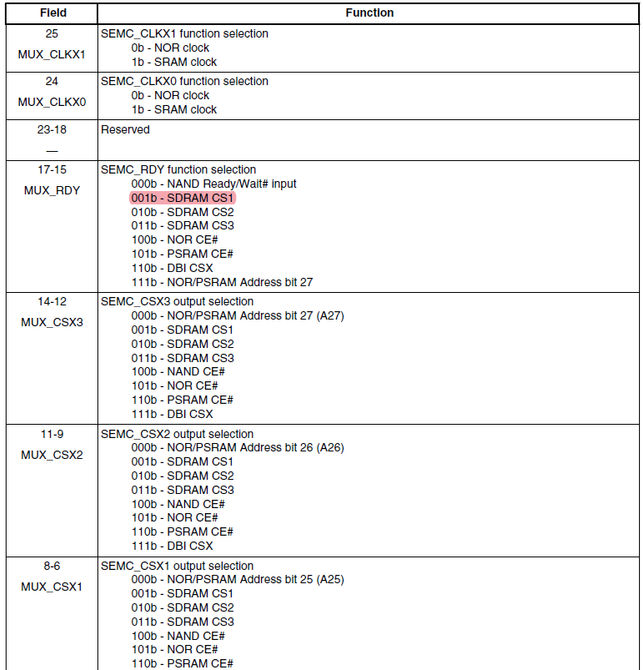

Hi all,
I have two SDRAMs on my customize board. The CS pins are IOMUXC_GPIO_EMC_29_SEMC_CS0 and IOMUXC_GPIO_B0_02_SEMC_CSX03, and the start address are 0x80000000 and 0x8C0000000, respectively.
I used semc_sdram example code to set both of them. And the SDRAMs can be read and written correctly.
Next step, the semc related registers were read out and recorded. So I filled out these values to dcd.c and comment out BOARD_InitSEMC(). However, the values read from the second SDRAM were wrong (the first SDRAM is okay).  And I have localized the problem which comes from Mode setting in dcd.c. But the  IPTXDAT of the second one is the same as the first one, so I cannot ffigure out the reason.
There is a question I need to make sure. Could I initialize two SDRAMs by dcd.c, or just one?
my dcd.c:

MCW
Hi @jingpan ,
I have one more question. I used the default dcd.c which IOCR defualt value is 0x79A8. And then I applied SEMC_ConfigureSDRAM function to set two sdrams. The read/write result of the second SDRAM was wrong. However, the read/write result was correct when I set the value of IOCR as 0x39A8 in the dcd.c. I have checked the datasheet, 15-17 bits of IOCR register are used for SEMC_RDY function selection. For my customize board, I don't use the SEMC_RDY pin because it is assigned for other gpio function.
Why setting MUX_RDY to 001 has some impacts on the second sdram read/write?
Best regards.
Doris
2,837 Views
jingpan
Hi @MCW ,
To MUX_RDY field, 0x00079a8 is same to 0x00039a8. It is bit 17~15, all zero. What different is MUX_CSX3.
Jing
