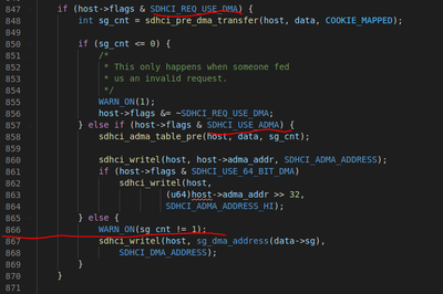

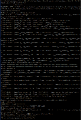

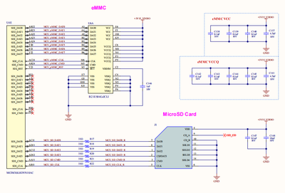

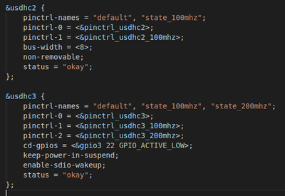

We have a customized imx6sl board with eMMC(usdhc2) and a sd card slot(usdhc3)
Sometimes from SD card writing files to eMMC will lead to a kernel crash(but didn't happen every time).
Sometimes, the eMMC write will lead to a kernel warning then the kernel might have the possibility to crash. The larger file/more files, has more possibilities to get this error. I test dd/cp command both can trigger the kernel crash.
I wonder if there is something wrong with my eMMC driver or dtb configuration ?
Following is the schematic/ dts of our board.

root@acuvims_hmi:/mnt/opt# cp -r /usr /mnt/opt
------------[ cut here ]------------
WARNING: CPU: 0 PID: 125 at /home/jie/Desktop/Acuvim-s/imx-yocto-bsp/build-acuvims-hmi/tmp/work-shared/acuvims_hmi/kernel-source/drivers/mmc/host/sdhci.c:866 sdhci_send_command+0xa9c/0xb2c
Modules linked in: evbug galcore(O)
CPU: 0 PID: 125 Comm: mmcqd/2 Tainted: G           O    4.9.88-develop_acuvims-hmi_jietang+g8d48165 #2
Hardware name: Freescale i.MX6 SoloLite (Device Tree)
[<8010ecb4>] (unwind_backtrace) from [<8010b394>] (show_stack+0x10/0x14)
[<8010b394>] (show_stack) from [<803c15ec>] (dump_stack+0x78/0x8c)
[<803c15ec>] (dump_stack) from [<8012dc2c>] (__warn+0xe8/0x100)
[<8012dc2c>] (__warn) from [<8012dcf4>] (warn_slowpath_null+0x20/0x28)
[<8012dcf4>] (warn_slowpath_null) from [<807223ac>] (sdhci_send_command+0xa9c/0xb2c)
[<807223ac>] (sdhci_send_command) from [<80723a38>] (sdhci_irq+0xabc/0xb64)
[<80723a38>] (sdhci_irq) from [<80171960>] (__handle_irq_event_percpu+0x50/0x11c)
[<80171960>] (__handle_irq_event_percpu) from [<80171a48>] (handle_irq_event_percpu+0x1c/0x58)
[<80171a48>] (handle_irq_event_percpu) from [<80171abc>] (handle_irq_event+0x38/0x5c)
[<80171abc>] (handle_irq_event) from [<80174e54>] (handle_fasteoi_irq+0xd0/0x1a0)
[<80174e54>] (handle_fasteoi_irq) from [<80170c6c>] (generic_handle_irq+0x24/0x34)
[<80170c6c>] (generic_handle_irq) from [<80171180>] (__handle_domain_irq+0x7c/0xec)
[<80171180>] (__handle_domain_irq) from [<801014d0>] (gic_handle_irq+0x48/0x8c)
[<801014d0>] (gic_handle_irq) from [<8010bd8c>] (__irq_svc+0x6c/0xa8)
Exception stack(0x885d1e18 to 0x885d1e60)
1e00:                                                       8845c300 60000113
1e20: 8818e680 00009a03 885d1e84 00000000 8845c300 00000000 885ce5fc 8845c300
1e40: 00000000 8845c2fc 885d1e90 885d1e68 80167690 809b9920 60000113 ffffffff
[<8010bd8c>] (__irq_svc) from [<809b9920>] (_raw_spin_unlock_irqrestore+0x20/0x54)
[<809b9920>] (_raw_spin_unlock_irqrestore) from [<80167690>] (prepare_to_wait_event+0x64/0x100)
[<80167690>] (prepare_to_wait_event) from [<8070c674>] (mmc_start_areq+0x2e8/0x388)
[<8070c674>] (mmc_start_areq) from [<8071c000>] (mmc_blk_issue_rw_rq+0xac/0x364)
[<8071c000>] (mmc_blk_issue_rw_rq) from [<8071d1d0>] (mmc_blk_issue_rq+0x11c/0x220)
[<8071d1d0>] (mmc_blk_issue_rq) from [<8071d380>] (mmc_queue_thread+0xac/0x130)
[<8071d380>] (mmc_queue_thread) from [<8014981c>] (kthread+0x108/0x110)
[<8014981c>] (kthread) from [<80107950>] (ret_from_fork+0x14/0x24)
---[ end trace 2550a7b95c0b4412 ]---

Unable to handle kernel NULL pointer dereference at virtual address 00000000
pgd = 80004000
[00000000] *pgd=00000000
Internal error: Oops: 17 [#1] PREEMPT SMP ARM
CPU: 0 PID: 116 Comm: mmcqd/1 Tainted: G        W  O    4.9.88-develop_acuvims-hmi_jietang+g8d48165 #2
task: 88288580 task.stack: 88490000
PC is at blk_rq_map_sg+0x148/0x47c
LR is at blk_rq_map_sg+0x140/0x47c
pc : [<803a9198>]    lr : [<803a9190>]    psr: 40030113

[<803a9198>] (blk_rq_map_sg) from [<80719d60>] (mmc_blk_data_prep+0x190/0x2bc)
[<80719d60>] (mmc_blk_data_prep) from [<80719ec0>] (mmc_blk_rw_rq_prep+0x34/0x154)
[<80719ec0>] (mmc_blk_rw_rq_prep) from [<8071bff0>] (mmc_blk_issue_rw_rq+0x9c/0x364)
[<8071bff0>] (mmc_blk_issue_rw_rq) from [<8071d1d0>] (mmc_blk_issue_rq+0x11c/0x220)

I found the eMMC and sd card are driven with DMA when booting up.
and from the source code, it seems if I enable the ADMA I can bypass this warning.
So I want to have a try here. How can I enable ADMA for eMMC and SD cards on IMX6SL? Or can I disable the DMA using PIO instead? Also, I notice it seems having some issues with the ADMA driver on IMX6SL? Is that fixed? can I use ADMA for emmc and SD card? https://community.nxp.com/t5/i-MX-Processors/ADMA-not-working-on-imx6sl/td-p/381698
appreciate for any ideas or advice.

Yes, sometimes the image copy doesn't have any problems like the following:
Sometimes copy from sd card to eMMC will lead to kernel crash like the following:
The yocto repo we used is based on yocto project User's guide: https://source.codeaurora.org/external/imx/imx-manifest -b imx-linux-rocko -m imx-4.9.88-2.0.0_ga.xml.
The Linux kernel we used is:
https://source.codeaurora.org/external/imx/linux-imx -b imx_4.9.88_2.0.0_ga
 I checked the kernel source code inside sdhci.c. 866 lines. the warning seems related to the DMA data copying. the scatter-gather count larger than 1.
