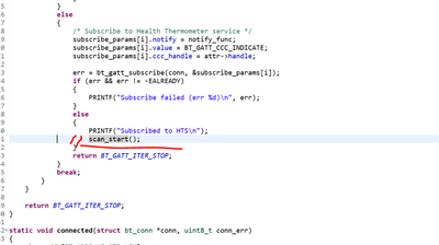

I am trying to connect my BLE Client (iMXRT1060 +ublox module) with 2 servers (QN9090). I was able to successfully connect to one board and read the data. When I try to establish connection with both the servers only one gets connected and for the other module I get the error as below,
Found device:
Create connection failed (err -12)

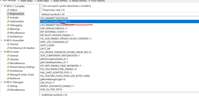

I have configured the CONFIG_BT_MAX_CONN to 2 and have done the required modifications in the central_ht.c file to connect to 2 servers. But I understand from the above error that the SDK currently supports only one connection. Is that correct?
Is there any sample SDK to connect to multiple servers as we need to connect to multiple peripherals to get data. Your help on this is highly appreciated.

Does the edgefast bluetooth example in iMXRT 1060 SDK support multiple connections? I am using the ublox module so I have defined the macro WIFI_BOARD_AW_CM358. The sdk code for edgefast bluetooth is different from the freedom series code.
I have defined the macro CONFIG_BT_MAX_CONN to 2 and have also done changes in the central_ht.c file to support 2 connections. But looks like I can establish only one connection at a time.

nxf56274
I wrote a code but I do not have the device. So I hope you can test it. I am trying to use the array to store the connection info.
35,912 Views
EmbeddedTech
I have tested the code and it is asserting after subscribing to one service. Please find attached the screenshots for your reference.
Thanks.
35,902 Views
nxf56274
1 Comment the 'scan_start', Does it work with only one device?
2 If so, please try to create a thread. In the thread, the uart is waiting for the cmd to call the scan_start after the first device sending the data normally.

EmbeddedTech
Do you mean like setting some sort of flag in the notify function on first receive and then use the flag in a new task to start scanning again?
35,887 Views
nxf56274
Yeah, this method works on kw. So I want you to try.
35,884 Views
EmbeddedTech
Please find attached the file and the screenshot. Let me know if it makes sense. I will do some more testing to see if its consistent and will also do changes to my custom peripherals read to see if it works.
Thanks.
35,878 Views
nxf56274
Yeah, it looks good
