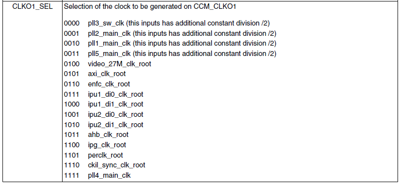

Unfortunately, I don't see any activity on the CSI0_MCLK/CCM_CLKO1 pin. I've checked the device tree hierarchy to make sure that no other peripherals are using that pin. I've also tried adding the following code to the arch/arm/mach-imx/clk-imx6q.c file
printk("Trying to set CLKO1...\n");
    ret = clk_set_parent(clk[cko1_sel], clk[pll4_audio_div]);
    if (!ret){
ret = clk_set_parent(clk[cko], clk[cko1]);
printk("CLKO1 set parent\n");
    if (ret)
pr_warn("failed to set up CLKO1: %d\n", ret);
in the same way that cko2 is configured, but still with no luck and I'm wondering how I'm doing wrong..
Could someone help me understand which are the required steps to correctly configure the CCM_CLKO1 signal?

On which part are you selecting the clock option made in the CCM_CCOSR register?
Alejandro
2,922 Views
alejandrolozan1
Sorry, I just realized you have the code in the clk-imx6q.c.
Can you double check the contents of the registers? You can use the unit_tests for such task, memtool or the dump-clocks.sh utility may be helpful.

I am suggesting that there might be something missing and looking at the regsiter contents may be helpful to narrow down the problem.
