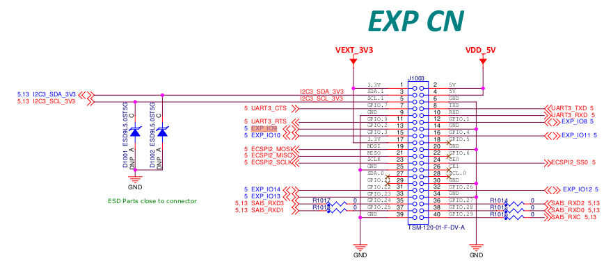

I first try to use GPIO 9 of the expansion connector as as input GPIO:
root@imx8mmevk:~# echo 505 > /sys/class/gpio/export
root@imx8mmevk:~# echo in > /sys/class/gpio/gpio505/direction
Then I connect pin 13 of the expansion connector to 3.3V and read value:
root@imx8mmevk:~# cat /sys/class/gpio/gpio505/value
0
Value of GPIO stays to 0.
Moreover, when configuring GPIO as output, and measuring voltage of the GPIO, I always measure 0V even when value in set to 1.

ebecam
Thanks for the links Jimmy.
I finally manage to control GPIO of the expansion connector by using the following commands:
For GPIO 9 of the expansion connector as as input GPIO:
root@imx8mmevk:~# echo 507 > /sys/class/gpio/export
root@imx8mmevk:~# echo in > /sys/class/gpio/gpio507/direction
Then when connecting pin 13 of the expansion connector to 3.3V and reading value:
root@imx8mmevk:~# cat /sys/class/gpio/gpio507/value
1

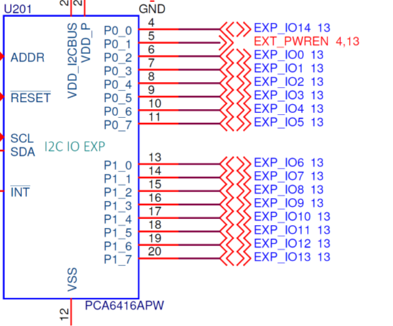

charles_pacey
Hi Sasa,
     The gpio pins here are driven through and i2c i/o expander chip.  If you look on sheet 6 of the schematic, you will see that the GPIO_IOxx pins are connected to the expander outputs such that P0_0 is connected to EXP_IO14 and EXP_IO0 starts sequentially at P0_2.   You can confirm this behavior with the below commands to toggle the pins gpio496 and gpio511 to confirm:
Pin 31 = EXP_IO14 = gpio496
Pin 33 = EXP_IO13 = gpio496+15 = gpio511
1) export both gpio for userspace.
root@imx8mmevk:~# echo 496 > /sys/class/gpio/export
root@imx8mmevk:~# echo 511 > /sys/class/gpio/export
2) set them as outputs
root@imx8mmevk:~# echo out > /sys/class/gpio/gpio496/direction
root@imx8mmevk:~# echo out > /sys/class/gpio/gpio511/direction
3) Set the values of them to 1 and 0 and confirm 3.3V and 0V accordingly
    to confirm:
Pin 33 = EXP_IO13 = gpio511
root@imx8mmevk:~# echo 1 > /sys/class/gpio/gpio496/value
root@imx8mmevk:~# echo 0 > /sys/class/gpio/gpio496/value
