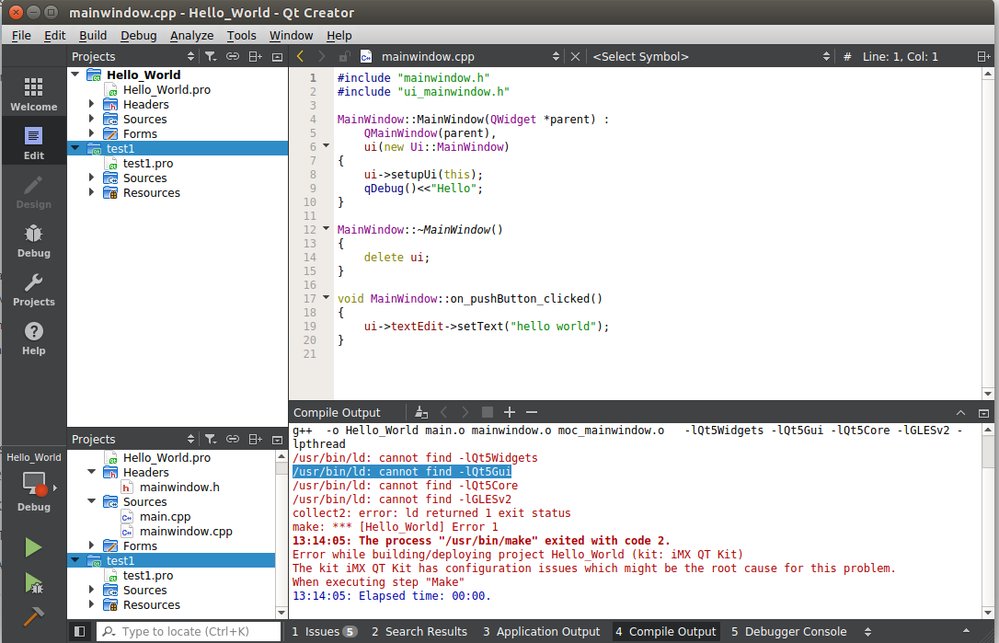

deepika_t
Hi Gusarambula,
I followed https://community.nxp.com/docs/DOC-328543  .After doing the set up mentioned in the document. I am getting error in compiling a hello-world program. There  may be some configuration error. Please take a look on the error and let me know .Selection_015.png

deepika_t
Thanks gusarambula‌
I will follow the steps for creating a QT Creator using bitbake meta-toolchain-qt5 . Will try to compile a simple hello world. Then i ll come back to you in case of help.
Thanks for help
Deepika

gusarambula
Hello Deepika,
I’m glad to hear you were able to bake the qt5 image.
As for compiling a Qt application, you would first need to extract the Qt5 toolchain, which you may do using the command:
After that you would have a script on the following path which you may run to install the toolchain.
fsl-release-bsp/<BUILD_DIR>/tmp/deploy/sdk/poky-glibc-x86_64-meta-toolchain-qt5-cortexa9hf-vfp-neon-toolchain-<VERSION>.sh
After that you would need to setup an IDE like Qt Creator. There are some documents on the communities like the following:
If you need something more specific to Qt I would recommend looking at the Qt forums where there may be more help specifically on how to build Qt applications.
