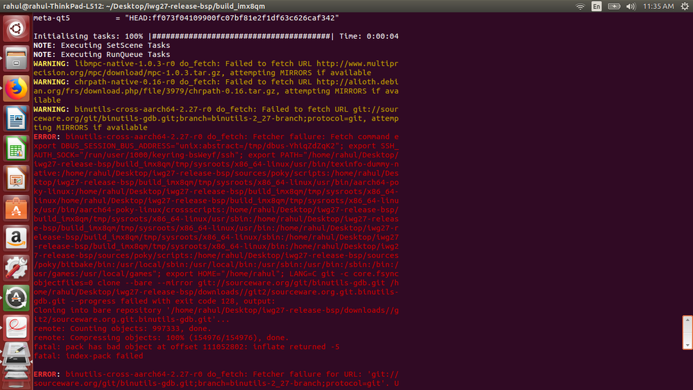

I have recevied this below error message during the compilation of meta-toolchain, How to resolve this issue,
Command used : bitbake meta-toolchainScreenshot from 2019-02-11 11_35_08.png
WARNING: glibc-initial-2.24-r0 do_fetch: Failed to fetch URL git://sourceware.org/git/glibc.git;branch=release/2.24/master;name=glibc, attempting MIRRORS if available
ERROR: glibc-initial-2.24-r0 do_fetch: Fetcher failure: Fetch command export DBUS_SESSION_BUS_ADDRESS="unix:abstract=/tmp/dbus-YhiqZdZqK2"; export SSH_AUTH_SOCK="/run/user/1000/keyring-bsWeyf/ssh"; export PATH="/home/rahul/Desktop/iwg27-release-bsp/build_imx8qm/tmp/sysroots/x86_64-linux/usr/bin/aarch64-poky-linux.gcc-cross-initial-aarch64:/home/rahul/Desktop/iwg27-release-bsp/sources/poky/scripts:/home/rahul/Desktop/iwg27-release-bsp/build_imx8qm/tmp/sysroots/x86_64-linux/usr/bin/aarch64-poky-linux:/home/rahul/Desktop/iwg27-release-bsp/build_imx8qm/tmp/sysroots/imx8qm_iwg27m/usr/bin/crossscripts:/home/rahul/Desktop/iwg27-release-bsp/build_imx8qm/tmp/sysroots/x86_64-linux/usr/sbin:/home/rahul/Desktop/iwg27-release-bsp/build_imx8qm/tmp/sysroots/x86_64-linux/usr/bin:/home/rahul/Desktop/iwg27-release-bsp/build_imx8qm/tmp/sysroots/x86_64-linux/sbin:/home/rahul/Desktop/iwg27-release-bsp/build_imx8qm/tmp/sysroots/x86_64-linux/bin:/home/rahul/Desktop/iwg27-release-bsp/sources/poky/scripts:/home/rahul/Desktop/iwg27-release-bsp/sources/poky/bitbake/bin:/usr/local/sbin:/usr/local/bin:/usr/sbin:/usr/bin:/sbin:/bin:/usr/games:/usr/local/games"; export HOME="/home/rahul"; LANG=C git -c core.fsyncobjectfiles=0 clone --bare --mirror git://sourceware.org/git/glibc.git /home/rahul/Desktop/iwg27-release-bsp/downloads//git2/sourceware.org.git.glibc.git --progress failed with exit code 141, output:

ERROR: glibc-initial-2.24-r0 do_fetch: Fetcher failure for URL: 'git://sourceware.org/git/glibc.git;branch=release/2.24/master;name=glibc'. Unable to fetch URL from any source.
ERROR: glibc-initial-2.24-r0 do_fetch: Function failed: base_do_fetch

Hi Santhosh Kumar,
Are you running behind any proxy server? If this the case then make sure that this URL is not getting blocked in your firewall as I am able to clone the repo successfully (link given in above snap).
$git clone git://sourceware.org/git/glibc.git - This is successfully cloned on my machine.

hi,
its nothing related to internet connection.. its related to permission, some file are unable to overwrite so you will get this issue,
just do sudo chmod -R 777 * to the entire build folder (it will take roughly 2 hrs to do this task due to yocto size) and then compile again

radhikasomaiya
Senior Contributor II
Hi Samyuktha S,
It looks like network issue as you are not able to fetch a url "git://sourceware.org/git/binutils-gdb.git". Are you able to clone this separately on your machine?
$git clone git://sourceware.org/git/binutils-gdb.git
If it fails, then I would recommend you to consult your network administrator.
