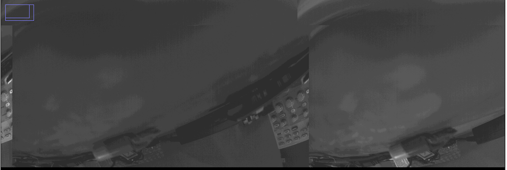

I run below command to capture one frame and its creating frame.raw file
v4l2-ctl --device /dev/video0 --set-fmt-video=width=2688,height=1520,pixelformat=BG10
v4l2-ctl --device /dev/video0 --stream-mmap --stream-to=frame.raw --stream-count=1
Once done I am able to convert that frame.raw file to png and image with black and white is there.

From the datasheet I came to know that "CFA (Chroma): RGB Bayer"
When I tried to capture the video using below command I am getting error:
root@iWave-G34M:~#
gst-launch-1.0 v4l2src device=/dev/video0 num-buffers=100 ! video/x-raw,width=1920,height=1080 ! vpuenc_h264 ! avimux ! filesink location=test.mp4
Setting pipeline to PAUSED ...
====== VPUENC: 4.4.5 build on Mar 20 2020 10:11:59. ======
wrapper: 3.0.0 (VPUWRAPPER_ARM64_LINUX Build on Feb 20 2020 11:05:40)
vpulib: 1.1.1
firmware: 1.1.1.65535
Pipeline is live and does not need PREROLL ...
Setting pipeline to PLAYING ...
New clock: GstSystemClock
ERROR: from element /GstPipeline:pipeline0/GstV4l2Src:v4l2src0: Internal data stream error.
Additional debug info:
../../../../git/libs/gst/base/gstbasesrc.c(3055): gst_base_src_loop (): /GstPipeline:pipeline0/GstV4l2Src:v4l2src0:
streaming stopped, reason not-negotiated (-4)
Execution ended after 0:00:00.001057125
Setting pipeline to READY ...
Setting pipeline to NULL ...
Freeing pipeline ...
root@iWave-G34M:~#
root@iWave-G34M:~#gst-launch-1.0 v4l2src device=/dev/video0 num-buffers=100 ! video/x-raw,width=2688,height=1520 ! vpuenc_h264 ! avimux ! filesink location=test.mp4
WARNING: erroneous pipeline: could not link v4l2src0 to vpuenc_h264-0, vpuenc_h264-0 can't handle caps video/x-raw, width=(int)2688, height=(int)1520
root@iWave-G34M:~#
Please provide the proper "gst-launch" command to capture the video or image for RGB Bayer format?
Is there any application is there to capture the image or video in linux ?
Anything I missed or configured wrong? Can you suggest me?

Hello devendradevadig,
Could you please describe how you converted the frame.raw file to png ?
