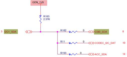

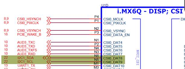

In SABRE board design, you can find that the I2C master signal comes from CSIO_DAT8 -> I2C1_SDA and CSIO_DAT9 -> I2C1_SCL pins on IMX6Q.

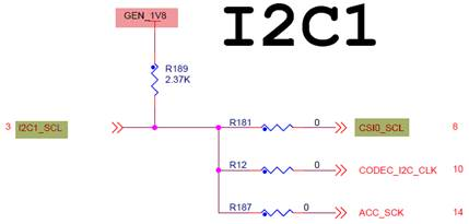

I2C1_SCL is connected to CSIO_SCL and I2C1_SDA is connected to CSIO_SDA, and both are connected with a pull-up to GEN_1V8

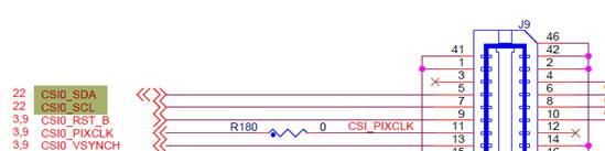

Then CSIO_SCL y CSIO_SDA is connected to J9 which is the camera connector for DVP.

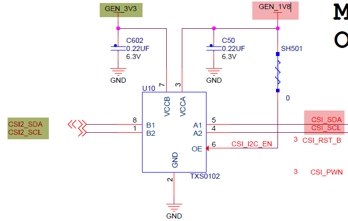

OPTION3:
You may use I2C level shifter, this device allows having different voltage levels in the same I2C rail, below you can see an example (U10) implemented in SABRE board:
If you consider option 3 to be the best option we can provide advice and recommend and NXP I2C level shifter.
