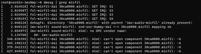

After the above command the dmesg | grep micfil output:

Secondly I was hoping you can give me more in site on the error:
[116004.923246] fsl-micfil-dai 30ca0000.micfil: ASoC: can't open component 30ca0000.micfil: -6
[116032.879723] fsl-micfil-dai 30ca0000.micfil: ASoC: can't open component 30ca0000.micfil: -6
[116440.582560] fsl-micfil-dai 30ca0000.micfil: ASoC: can't open component 30ca0000.micfil: -6
Does the error above indicate a problem with the device tree or the driver not being loaded properly? I am starting to believe this might not have anything to do with capturing audio but the driver not being able to load properly.

Hi Saksham
what bsp and dts used in the case, one can look at below (compatible = "fsl,imx8mp-micfil"; compatible = "fsl,imx-audio-micfil"; model = "imx-audio-micfil";)
https://source.codeaurora.org/external/imx/linux-imx/tree/arch/arm64/boot/dts/freescale/imx8mp-evk.d...
https://source.codeaurora.org/external/imx/linux-imx/tree/arch/arm64/boot/dts/freescale/imx8mp.dtsi?...
One can try to debug it using sect.7.6.4.2 Source Code Structure i.MX Linux Reference Manual​
https://source.codeaurora.org/external/imx/linux-imx/tree/sound/soc/fsl/fsl_micfil.c?h=imx_5.4.70_2....
