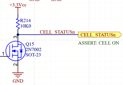

We are working with the i.MX 8M Mini processor implemented on DART-MX8M-MINI SoM on our custom CarrierBoard.
We are using GPIO5_IO03 as an input (+3.3V domain). This input is driven by an open-drain transistor with a pull-up resistor to +3.3V. There shall be no pull-down resistor in the signal path.
However, when I expect to read +3.3V on the input, I am reading ~ 2.5V. I suspect there is a pull-down in the input path creating a voltage divider.
I confirmed with Variscite (DART-MX8M-MINI manuf), and there are no pull-down on their SoM.
I have triple checked the register values for the IOMUX configuration for GPIO5_IO03 using memtool. They're as follow :
Pad mux : 0x1E8 -> 0x00000005 -> SPDIF_TX set to GPIO5_IO03
Pad control 0x450 -> 0x00000014 -> Disable pull resistors, Fast SR, X2 drive strength
See the attached picture for reference....
I suspect there is a pull-down of ~ 33kOhm somewhere. Our pull-up being 10kOhm, that sets the input voltage to ~ 2.5V
I tried changing the pull-up value to 2kOhm, and that increased the input voltage to ~3.11V.
So I am pretty sure there is a pull-down somewhere here, but I don't know where, nor how I can disable it.
I have seen the exact same behavior on GPIO1_IO12...
Thanks for your advice and have a great day!

Can you please share the schematic portion of input is driven by an open-drain transistor with a pull-up resistor to +3.3V?
Thanks & Regards
Sanket Parekh
69,065件の閲覧回数
lecejeff
Hi Sanket,
Sure, find attached the open-drain output driver with pull-up and associated input to the SoM.
The PWG# output comes from a TPS24701 (ideal diode controller) IC.
The DISPLAY_PWR_FLTn signal goes directly to GPIO1_IO12 of the i.MX 8M Mini :
Measuring the DISPLAY_PWR_FLTn at ~ 2.5Vcc right now, thus that would mean a pull-down of ~ 33k is present between DISPLAY_PWR_FLTn and GND.
I changed the pull-up value to ~2kOhm and the DISPLAY_PWR_FLTn signal measures ~ 3.11Vcc

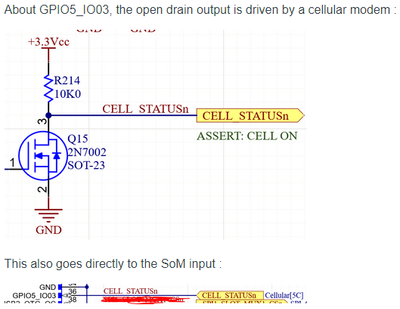

About GPIO5_IO03, the open drain output is driven by a cellular modem :
This also goes directly to the SoM input :
Let me know if you need anything else. Both inputs exhibit the same behavior.

Please see the attached image of the behavior of the GPIO5_IO03 (CELL_STATUSn) that I have probed on the scope. Please note that this GPIO is mapped to a linux driver and is properly instanciated in the device tree as an input without pull resistors (no PU, no PD, PE = 0
There are 2x phases : the GPIO state when linux is booting, and the final state once the drivers have been loaded. If the pull-down is "always on", can you please explain why the voltage pops from ~2.5V to ~3.3V when the system has finished booting?
FYI, the GPIO5_IO03 is driven by an open-drain output with a +3.3V pull-up of 10kOhm :
Thanks for your time and waiting for more details on your side.
