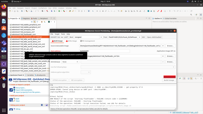

I tried to build the evkmimxrt1160_flashloader_cm7 (bootloader example) using MCUXpresso IDE. The generated axf/bin file flashed using MCu Secure Provisioning ToolV4.0 . While flashing the start address getting assigned as "0x20202000" & Getting error as like below,
Screenshot from 2022-05-12 18-44-00.pngScreenshot from 2022-05-12 18-44-00.png
Suggested any thing needs to config in project setting to load the sample boot loader code?

jeremyzhou
Please modify the linker as below shows, to avoid using the OCRAM M4 area.
MEMORY
  m_interrupts          (RX)  : ORIGIN = 0x20250000, LENGTH = 0x00000400
  m_text                (RX)  : ORIGIN = 0x20250400, LENGTH = 0x0001DC00
  m_data                (RW)  : ORIGIN = 0x20270000, LENGTH = 0x00010000
TIC

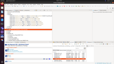

vishnusudhankj
@jeremyzhou
currently i am using default CM7 flash loader available in the MCUXpresso IDE & i am not modifying any memory region or partition .
Hope the default sample flash loader application will map to the CM7 core .
Is it possible where your reference to change the memory region?
Below is the memory region currently the default CM7 flash loader program has,
Screenshot from 2022-05-18 10-53-50.pngScreenshot from 2022-05-18 10-53-50.png
suggest us is that memory mapping is correct?
