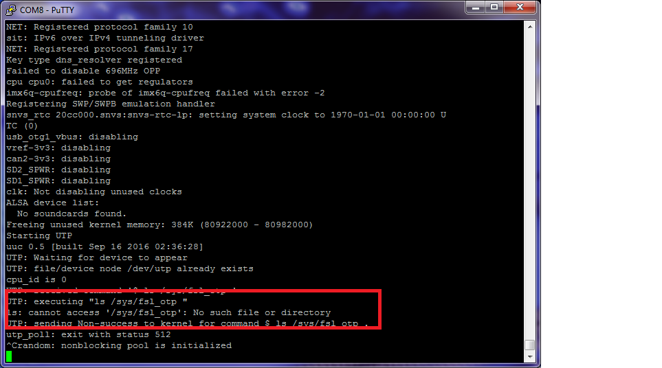

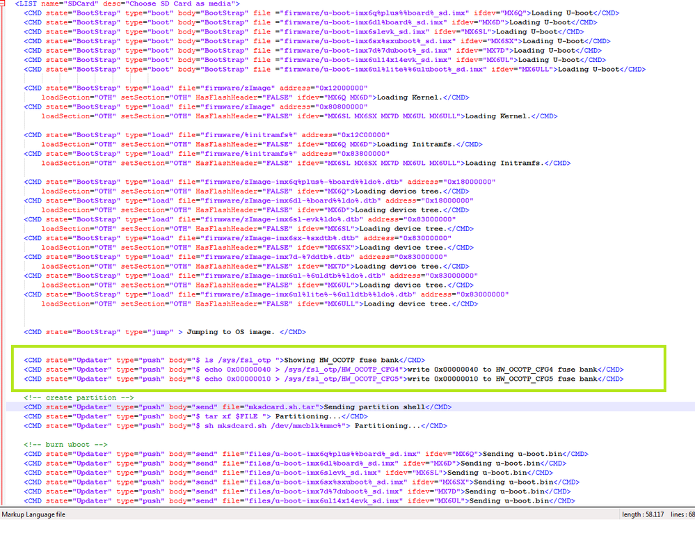

We added this lines to MFG TOOL to perform this equivalent uboot fuse prog:
For boot i.mx6Ultralite from SD1 also overriding resistors (wer have no resistors on custom board)
FINAL FUSES:
FUSE PROG 0 5 0X00000040
FUSE PROG 0 6 0X00000010
So we´ve added this lines to MFGTool
But it Fails
What´re we doing wrong?
