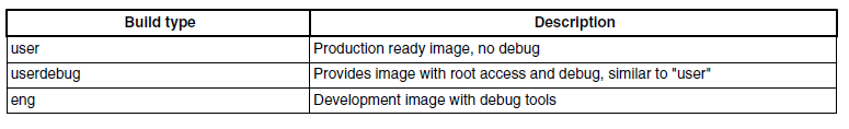

jimmychan
I think you used 'user' to build the source code. Please try to build the source code using 'userdebug'
for more information, please read the chapter 3.3 in Android User's Guide.
