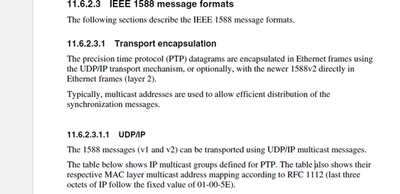

Hi NXP i.MX8M support,
  1. My initial question:
Would you have someone in your team that could confirm for me if (and which) i.MX8M families (Plus, Mini, Nano, M) support 1588 v2 (1-step) please? The confusing story  is that the 8M RM does have a tiny paragraph eluding to 1588v2 per snippet below. But, that’s it. Nowhere else in the RM does it show how to configure the MACs for 1588v2. So if 1588v2 is indeed supported, could NXP confirm for us and if there is collateral material to configure the devices for 1588v2, I would like to have the link to these docs please.
 See attached Doc #1

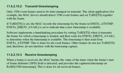

2. Answer from NXP:
I believe in most context when we mention IEEE 1588 implementation for our MCU/MPU products, it’s referred to IEEE 1588-2008 (v2).
Theoretically both one-step and two-step timestamping can be used under 1588v2. I don’t think it should be how we differentiate 1588v1 and 1588v2.
When coming to the actual support for one-step or two-step, it more depends on what driver to use and the timestamping implementation in the driver.
Also, please find below the confirmation and additional info from our i.MX SE team.
  • The i.MX8M families all support running IEEE 1588v2.
  • The 1588 clock timestamping implementation can be referred from the RM. E.g. for i.MX8MP,”11.6.2.10.2” and ”11.6.2.10.3”.
 See attached Doc #2:
