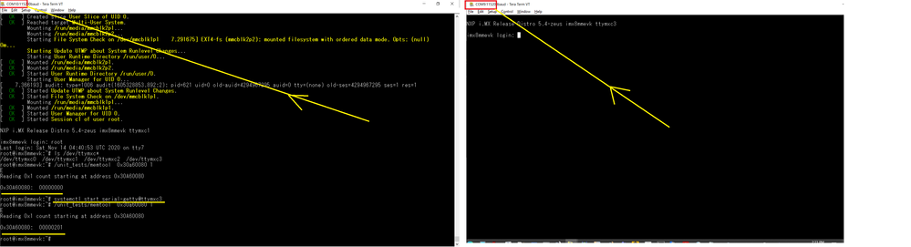

BiyongSUN, thank you for the reply.
You're absolutely right - I checked the UARTEN bit on the wrong point of time. After using the UART it is set: "Read at address 0x30A60080 (0xffffb460a080): 0x00000201"
I've found the error related to DTE mode too: it must be "fsl,dte-mode", not "fsl,dte_mode" (shame on me!)

BiyongSUN
because you haven't used the uart4.
here is the test, use the uart4 as second login/debug console.
