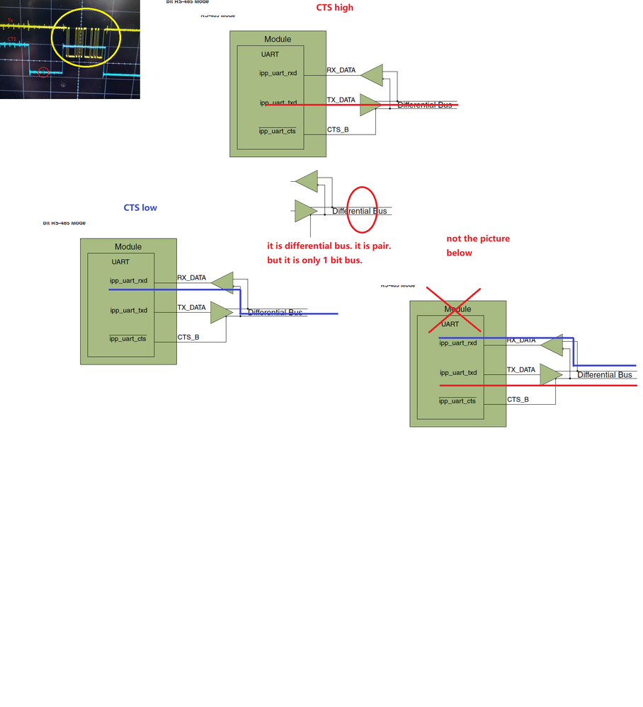

And I noticed there is another way using CTS as UART Controller's CTS_B signal to directly controll RS485 Transceiver's DE/_RE. which also mentioned by @weidong_sun , he said
---UART_CTS
UART_CTS pin controls IO direction, which may have better performance than GPIO mode, but it also depends on software to determine when TX ends or RX ends. There is always a delay.
So now i testing using CTS as UART Controller's CTS_B signal to directly controll RS485 Transceiver's DE/_RE, and modify device tree to:
&uart4 {
pinctrl-names = "default";
pinctrl-0 = <&pinctrl_uart4>;
rts-gpios = <&gpio3 2 GPIO_ACTIVE_HIGH>;
uart-has-rtscts;
linux,rs485-enabled-at-boot-time;
status = "okay";
pinctrl_uart4: uart4grp {
fsl,pins = <
MX6UL_PAD_UART4_TX_DATA__UART4_DCE_TX 0x1b0b1
MX6UL_PAD_UART4_RX_DATA__UART4_DCE_RX 0x1b0b1
MX6UL_PAD_LCD_HSYNC__GPIO3_IO02 0x1b0b1                    /* CTS  pin as gpio*/
MX6UL_PAD_LCD_HSYNC__UART4_DCE_CTS 0x1b0b1    /* dedicated CTS */>;
And now i got a strange behave on CTS output.
Below i let imx6ul send 5 byte date throught Uart4, i capture the CTS in Oscilloscope:
Strange Behave 1: why CTS held high before Tx datas?  (CTS  high means Tx in RS485 Transceiver)
Strange Behave 2: why CTS held high after Tx datas?  (CTS  high means Tx in RS485 Transceiver)
Strange Behave 3:  mybe correct.
Zoom in the first byte send:
Strange Behave 4:  why CTS held low a period before assert(set high) CTS to send data.
Any help are appreciated. Thank you in advance.

If you read the RS485 spec, you will find RS485 is "half-duplex" communication.
only receive or transmit at one time. that is why need control the direction.
The "before" and "after" is for "receiving".
If you read the i.MX6UL reference manual, you will find RS485 is "1 bit" differential bus.
BTW, data is the plural form of datum. no word "datas" in English.

BiyongSUN
Yes.
That is your  waveform.
CTS high has data on tx.
Have you sent date to i.MX6UL?  and you should measure the waveform on RX pin of i.MX6UL.

BiyongSUN
suggest you can use 0x33 data to make the waveform easy to analyze.

BiyongSUN
1. 确认一下用的BSP 的版本。主要是确认一下驱动。
2. 确认一下是用的标准的RS485 的编程。
比方 是用的这些结构。
struct serial_rs485 rs485conf;
memset(&rs485conf, 0, sizeof(rs485conf));
rs485conf.flags |= SER_RS485_ENABLED;
rs485conf.flags |= SER_RS485_RTS_ON_SEND;
rs485conf.flags &= ~(SER_RS485_RTS_AFTER_SEND);
3. 确定一下 dts 文件是按照binding guide 写的。
